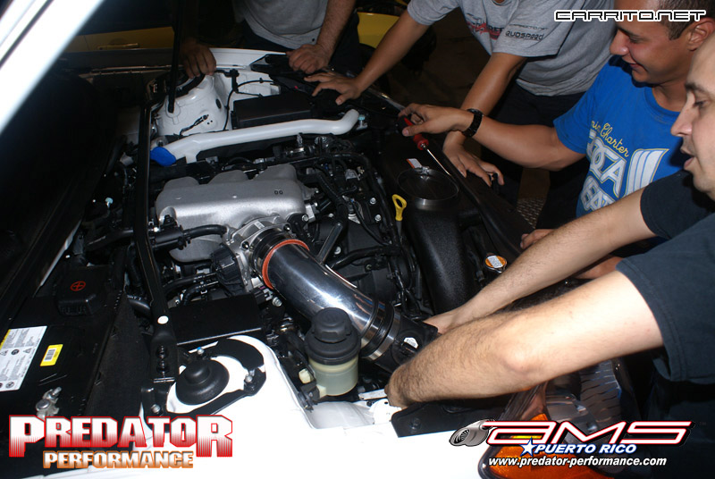

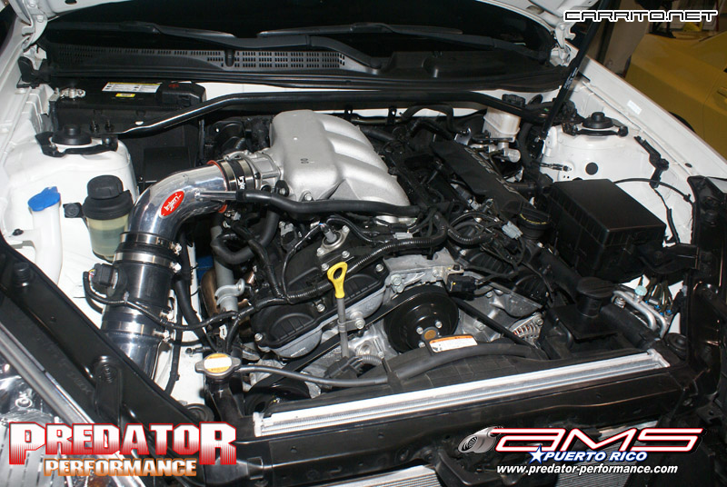

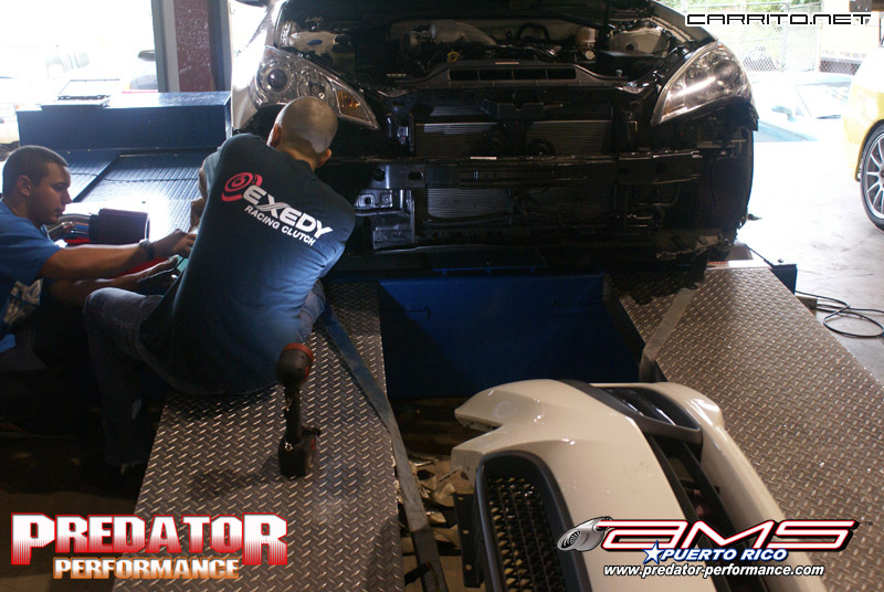

Well, time for next mod with Predator! Now its INJEN CAI turn.

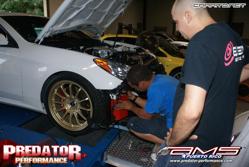

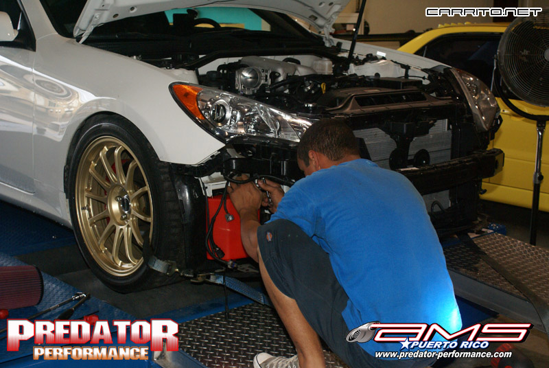

2 days ago we received an INJEN CAI Polished, we inmediatly proceeded to the dyno to do a base run, the results were 249whp. We already did a few passes a few days before of 255whp, but because we dont have any Piggyback for tunning, the OEM ECU its always retuning and changing AFR, etc.. Because the weather was pretty bad and raining, we said "Ok thats our base run for today" and started the installation right on the dyno.

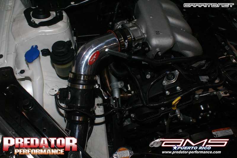

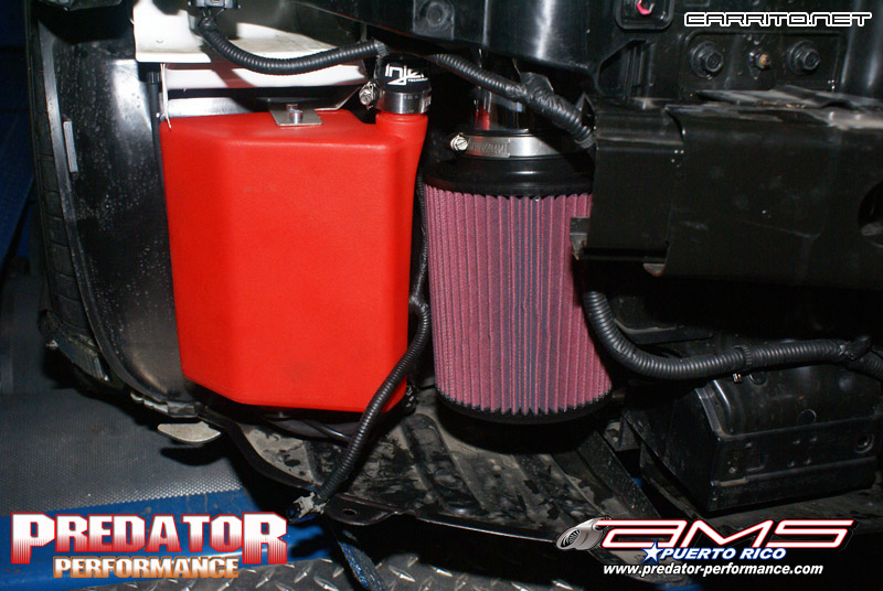

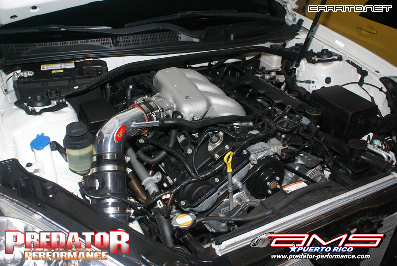

The fitment was great and all the mounting hardware included. Then we proceeded to do the dyno runs, the first run was 254whp, not bad, thats better than the base run, because the car keeps retuning itself we did a few more passes, the next one was 258whp and 229wtq! WOW! Thats better than any other run without the intake! After another run the result was 263whp and 230wtq! Ouchhh thats 14whp extra than using the K&N(and we already gained 8whp from the K&N)! Thats awesome!
263whp in our Mustang Dyno its almost 290whp in a Dynojet and near 345hp at the engine! Its +33whp from stock form! Not bad with just boltons and no tuning! Now we need to find a stock 370Z!

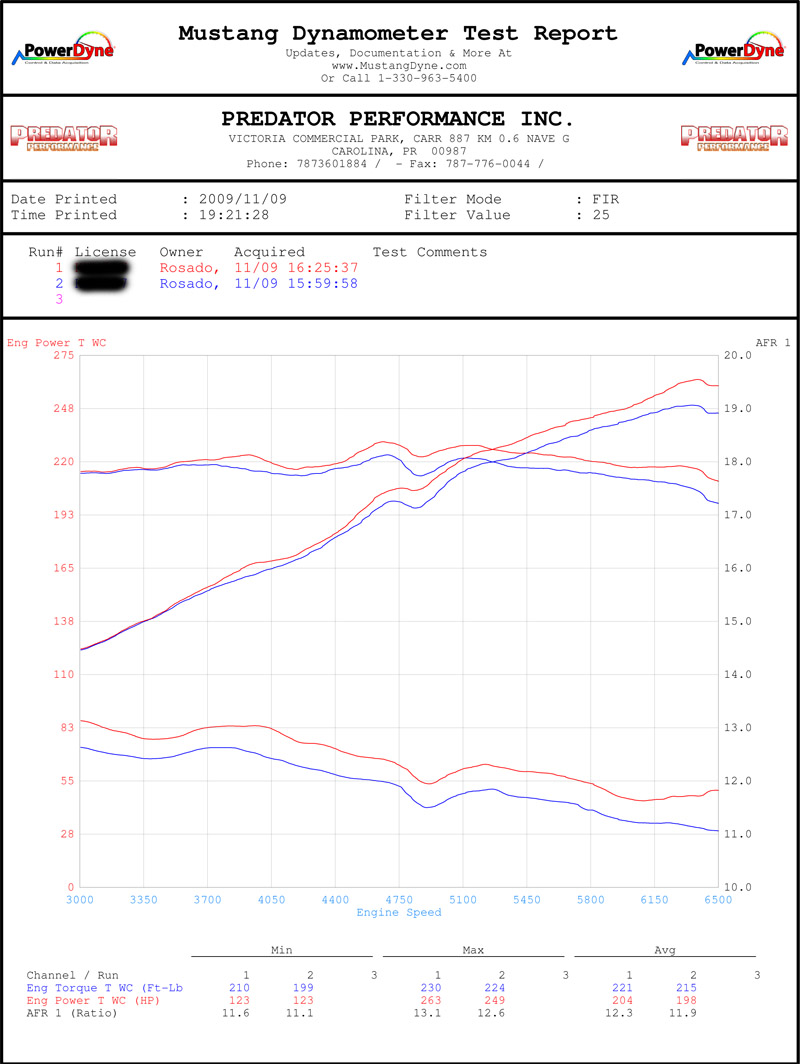

Here is the dyno chart:
You can see that the second run was 30 minutes after(thats how long it took us to remove bumper, install CAI and reinstall everything)

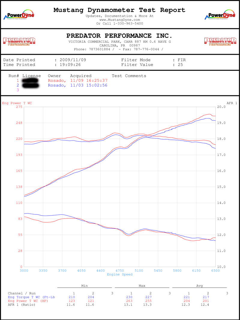

This is a comparison of the best run without CAI and the one we did after the CAI:
Awesome gains, who knows, maybe we will gain a few more whp after a few days of driving around like it happened with the headers.

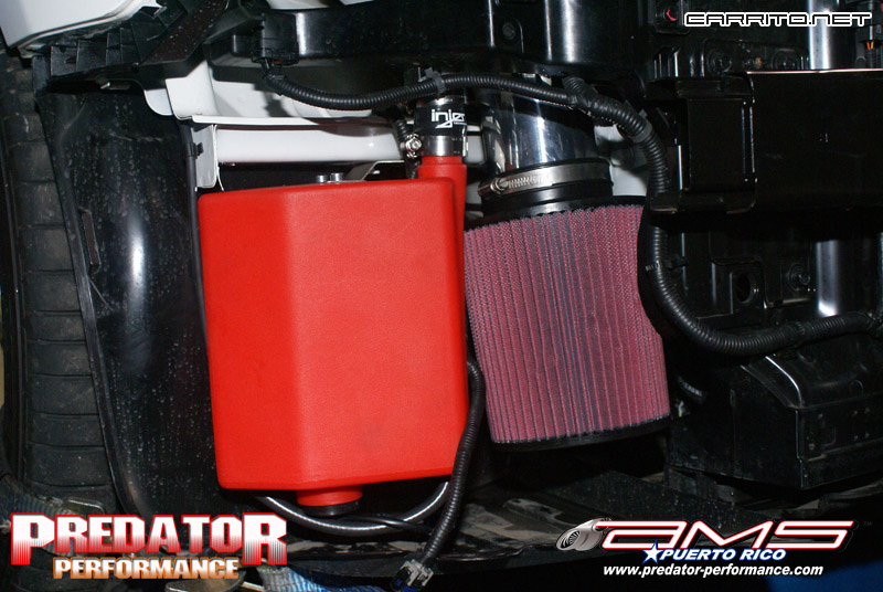

since yall know way more about tuning than i do maybe you can help me figure something out. what is the small pipe inside the intake tubing there for? the one on the upper elbow that goes beneath the MAF...
The small pipe inside the intake tubing (and other tubing tricks on various cars) is to get the MAF sensor to read correctly. You see MAFs measure Flow, and assume pipe diameter, to figure out the amount of air your engine is ingesting. It's like when you lick your finger and put your finger in the wind to figure out the winds direction, and wind speed. Well, if you knew the amount of air that is moving at one point in time and the speed at which it is moving, then you'd know the total volume of air that is moving. The MAF does just that, it measures speed of the air, and assumes the amount of air that is moving at one point in time. So, if you simply give the MAF a larger pipe, the MAF will not know it, and problems will occur, or if you change the speed and change the piping amount, the MAF may just do something a bit differently. I haven't seen a GenCoupe 3.8 MAF in close detail, and I know that the MAF on the GenCoupe has it's own piping section, so my guess is Injen put the pipe in to manipulate the Air Fuel Ratio to make more power, and to do it in a safe manner.
Whatever it's for, it's there for a purpose and it works. I'd leave it alone.

Correct me if I'm wrong Predator, but here's the info, in summary form:
Predator dyno'ed 230whp completely stock (best run)
Predator added K&N Filter and HKS axle back, and dyno'ed 243.5whp (best run)
Predator added headers, and dyno'ed 255.8whp (best run)
Finally Predator removed K&N Filter and added CAI, and dyno'ed 263whp (best run so far, they'll dyno more as it relearns)
This was done on 1) a Mustang Dyno; 2) In Puerto Rico; and 3) On his car.
Predator states that the K&N gave him 8whp. Which means that the axle back must be accounting for the other 5.5whp.
Here's the gains he saw:
K&N Filter, 8whp
HKS Axleback 5.5whp (assumed)
ARK Headers, 12.3whp
Injen CAI, additional 7.2whp on top of the 8whp that only a filter gave, roughly a total of 15.2whp (assumed) from the Injen CAI
Edit: Don't forget that weather (temperature, humidity, barometric pressure) plays a factor in all this, but that's the cold hard numbers. Also, the day they tested the CAI, the best run without the CAI produced 249whp (instead of 255.8 on a prior day/weather).
let me explain this a little better for anyone that hasn't seen the intake. inside the pipe that connects the MAF to the TB, on the MAF side there is a ~8 inch pipe on the MAF side. when you install the MAF this pipe fits 4-5 inches inside the MAF on the opposite side of the sensors and touches the front screen. i don't understand how that helps the MAF read anything.
I think it's creating a small venturi effect or the Bernoulli principle if you will. The pressure drop induced by the increase in velocity of a fluid passing through a narrow orifice can be used to create a low pressure area downstream of the narrowing. Thus dropping pressure below atmosphere pressure effectively pulling air through the entire tube. Air moves from high pressure to low, this is how airplanes fly.....So if you can drop the pressure in the intake you can create an artificial vacuum. Looks like Injen done did some thinkin'.
K&N Filter, 8whp
ARK Headers
KN filter
HKS axleback
255whp best dyno
249whp was their baseline they recorded on the day they installed and re-dynoed with the CAI.
We need to take into account the different temperatures that vary per day and time of the year.
