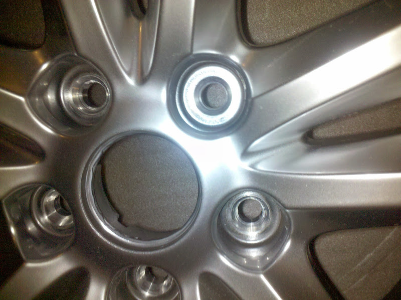

I am happy with the results and would endorse this method. I have never done anything like this and managed to get through it. I did all of this with Aerosol cans. Those of you who have air brush equipment can make it look even better. Here is a photo synopsis of the job.
Prep work and preview of curb rash

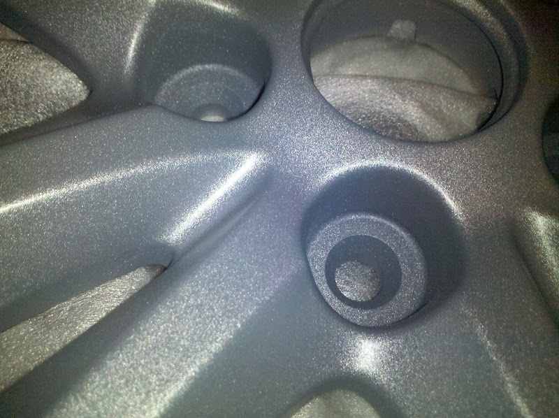

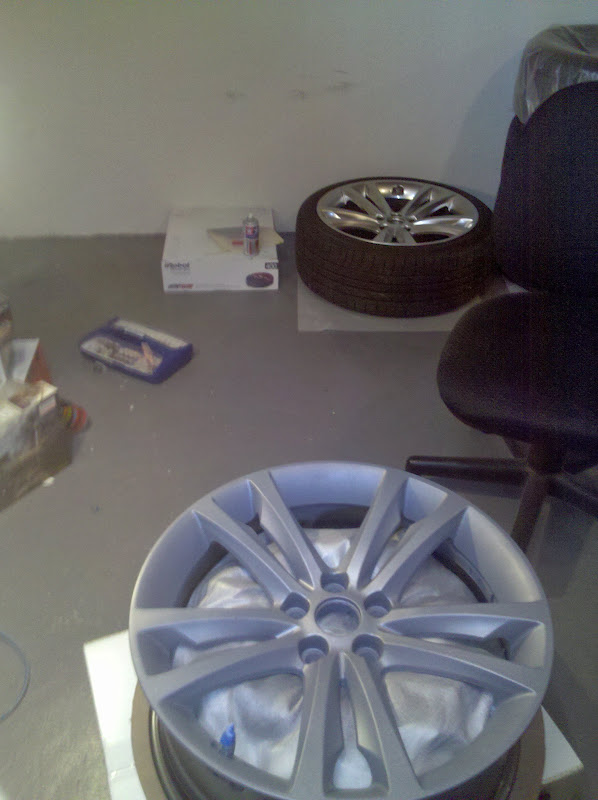

First of many coats of Spot Bondo. Used 320 grit for first 2 layers. Then 600 to finish. Basically apply small amounts at a time to fill in slowly. End with fine grit (1000) to even out smoothness.
Taper primer from damage out.
Frist coat of 3. These coats are all tapered from damage source towards center of spokes.
After base coat but before the clear coat. Dry to touch paint still settling in. You can see the curb rash is gone.
After 3 light coats of clear applied. Color set in nicely.

btw my curbrash was slightly worse, it hit the aluminum, not just paint.
so i took the tire off the wheel and am painting the whole thing. hopefully the finished product will match close enough to the other wheels. if not - not sure what i will do.
right now i am at a clean primer stage, ready for paint, hopefully before it gets dark today. plan to put some duplicolor clear wheel sealer on it as a clear coat.

i just put a coat on the wheel and i already can tell its not a match for me. it looks like grey with specs of glitter! .... i dont know what i;m going to do with this, im ready to give up and put the 19"s for sale in the private classifieds..
look at this crap!
supposed match:
oem:
