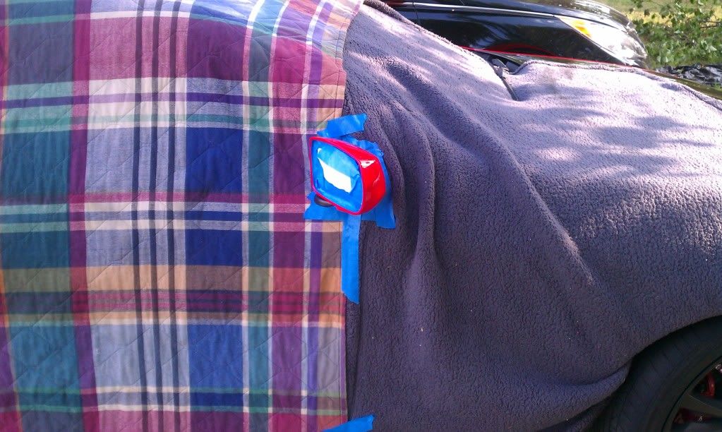

CantFindMeHaha: Mirriors, On-Car:
1. Clean the bugg crap off your Mirrors.
2. Cover the car with a blanket or sheet, something to keep the PDip from getting it.
3. Line the rim of the mirror with painters tape and block off the mirror so no paint can spray through(You can wipe it off if it does.) And yes I realize my taping wasn't the greatest, but the lines came out straight like they were supposed too! =P I got lazy... it's PDip so I don't care as much lol.
4. There are three different adjustment positions to work with, I started in this one.
I sprayed the inner are of the mirrors base first and then pushed the mirror towards the car and got the back half of the base nearest the car.
When you adjust the mirror it won't rub against anything to disturb the paint, but this are takes the longest to dry.
Then I just put the mirror in it normal position and sprayed normally making sure to get all the edges that showed any red.

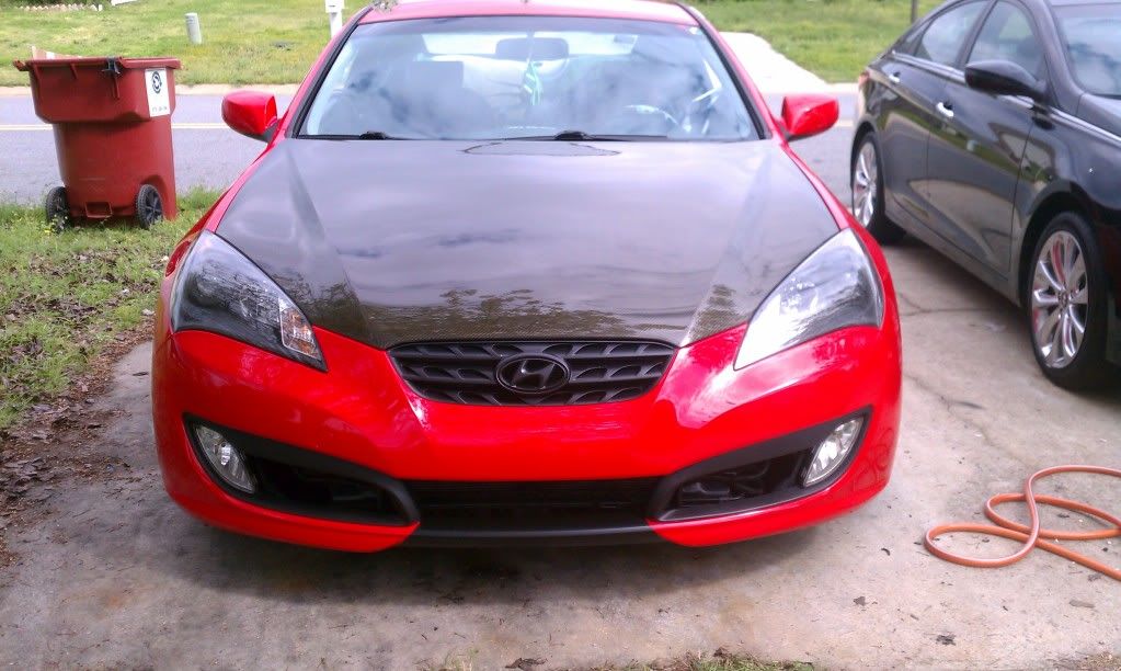

HOOD STUFF (RICER FTW):
My girlfriend was during her round of chemo (everything turned out great, btw) and her mom was in town, so they were watching girly movies. I got bored and went and played with my car. They ended up coming out and helping me do the hood.
Now for something like this, where you need a clean line, the best bet is to lay a thicker coat with complete coverage, and rip the tape up before the plasti-dip dries. Imagine doing your 4-6 coats, but with no dry time between them, and then ripping the tape to leave a clean line.
I liked the passenger side, girlfriend's mom wanted me to the driver side (way too race car livery for a stock height, stock engine daily driver lol):
Putting an extra coat and fixing wobbly lines from my original tape job:
