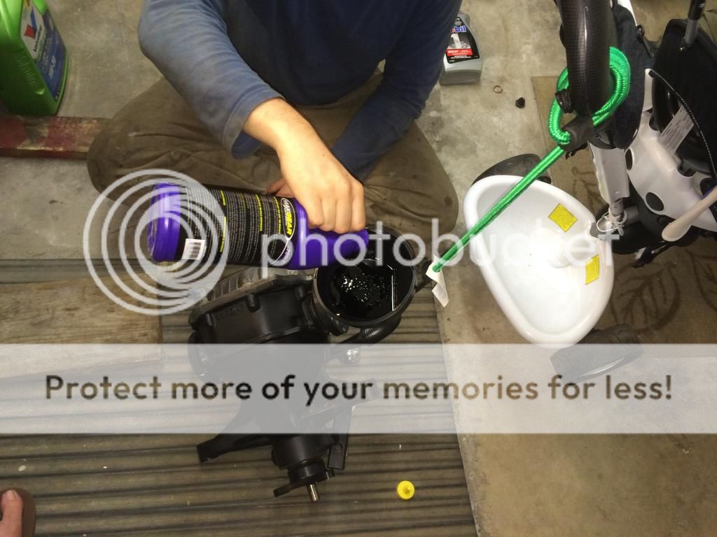

I used Royal Purple Max-Gear 75W90 gear oil. The diff takes 1.4L (1.48 US quarts).
Rigged up the funnel so we could pour in the gear oil and leave it without holding the damn thing up right. Gear oil funnels slow, so it takes a few minutes to fill.

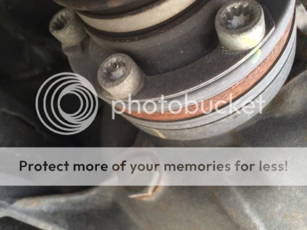

These are the 12-point Torx bolts on the axles. I used a kit I borrowed from a friend.. They're torqued down pretty tight and they're fairly long bolts. Don't strip them by trying to use a regular 6-point Torx kit :D One of my bolts were stripped already for some reason, so we had to hammer the torx bit in to break it loose.

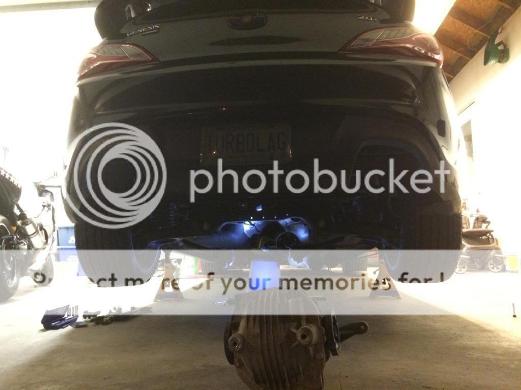

After you unbolt the axles from the diff, let them sit there and unbolt the driveshaft and then the 3 bolts holding the diff to the carrier. I used a hydraulic jack under the diff to slowly lower it down while a friend kept it straight. While you're lowering it, start moving the diff backwards towards the rear bumper of the car slightly to allow the input shaft pin on the diff to clear.
I'm not sure about the factory exhaust, or other exhausts for that matter, but on the Weir-Tech I had to unbolt the axle back, then unbolt the back hanger on the cat-back and bungee cord it off to the side so the diff would clear.
Old crappy open-diff out of the car.
New one went in fairly straight forward. Make sure you have someone holding it straight when you jack it back up in to position. We bolted the drive shaft on first, then the axles and finally the carrier bolts.
To make the install easier, while the diff is sitting on the jack, lower it about 4-6 inches below the where it sits in the diff carrier and hand thread two bolts on each axle because once the diff is up in it's spot the axles won't clear and you'll be taking more stuff apart. :D
