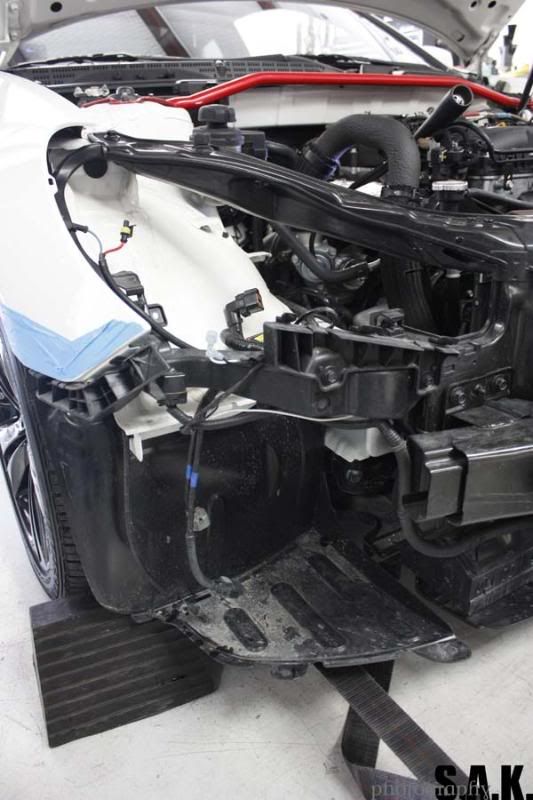

Since we didn’t have access to a lift we removed the front bumper.
1. Removed the plastic clips in front of the radiator.
2. Removed the headlamps. There are 2 10mm bolts that attach the headlamps to the car.
a. unclip the headlamp connector
b. once the 2 bolts are off, push from the back and lift up on the bottom of the front of the lamp.
3. There is a screw that attaches the bumper to the fender. It’s near the corner of the bumper.
4. There are 4 more clips (2 on each side) that attach the fender liner to the bottom of the bumper.
5. Once all the attaching clips and bolts are off you can remove the bumper.

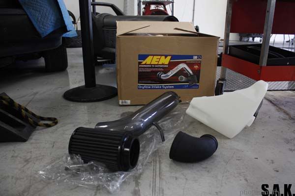

20. Install the supplied rubber elbow to the turbo. Use the supplied clamps.
a. Do not tighten them all the way, you’ll need to be able to move stuff around.
21. Install the rubber insulator on the metal bracket next to the radiator
22. Install the intake pipe.
a. The part with the 2 nipples goes by the motor
23. Take the 2 hoses supplied by AEM and install them onto the vent hoses on the Valve cover and tube.
a. Big hose on the bigger nipple and smaller one on the smaller nipple
b. Take the spring clamps off the OEM vent hoses and reuse them.
24. Use the supplied hose clamps and attach the hoses to the nipples on the AEM intake pipe.
25. Take the flat washer and 10mm nut and use them to hold the bracket to the insulator.

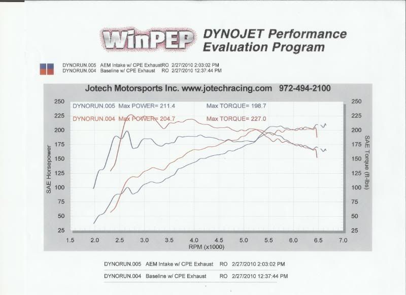

Dyno Showed 20hp gain throughout the mid-range.

so you picked up 7hp but lost 20tq's?
dyno 5 is the last one correct?
3.5L TT but wrong body
12,003 Posts
Wondering the same thing... Maybe the colors are switched? Blue shows as run #5, with intake, but lower power across the board...

You did have a silencer deleted on that stock exhaust run right?
464 Posts
unfortunately the "baseline" was with the CP-E Turbo back exhaust. We were not able to do a bone stock baseline run.
