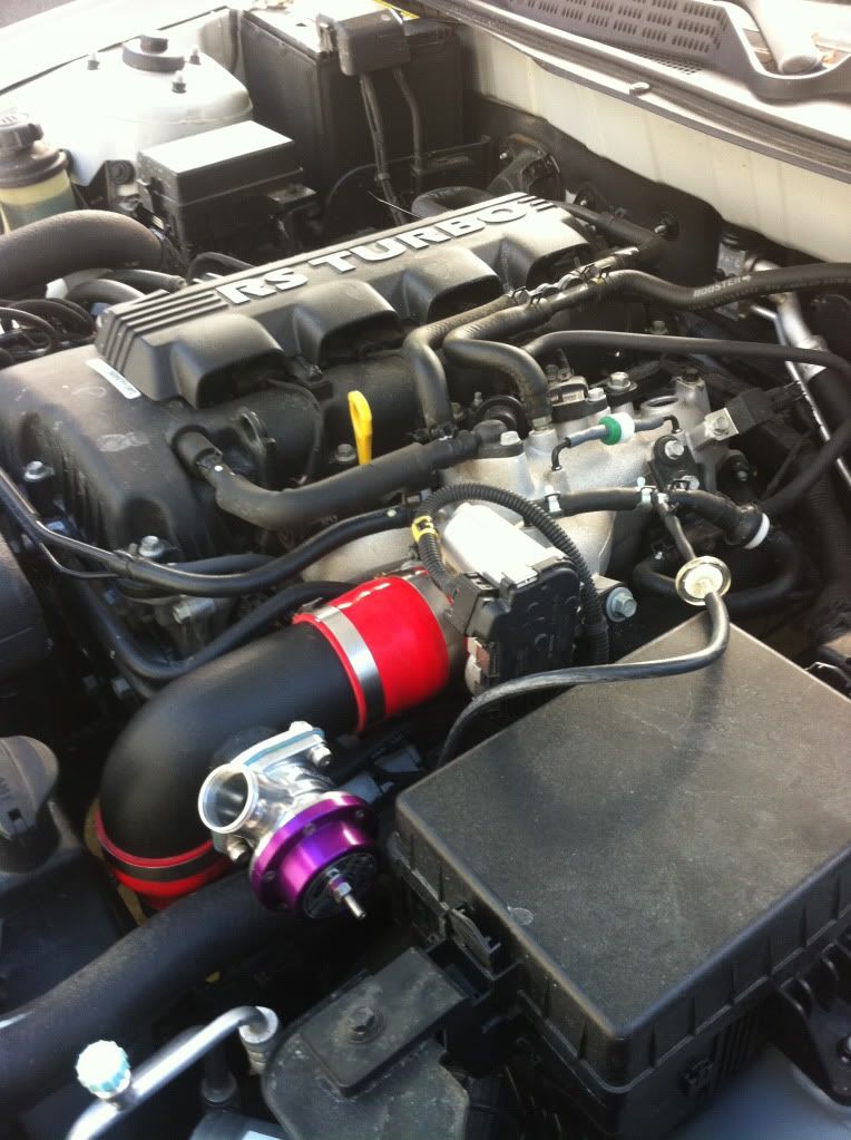

Like I promised, I said I would post pictures of it under the hood.
The fitment is perfect, and it's rather colourful under the hood! :rofl:
Anyway, I found the source of the boost leak, and all I needed was an allen key to tighten a single screw, as shown below.
Now that I'm no longer leaking boost and the BOV works fine, this thing is LOUD. I have no complaints whatsoever. Thanks Mike!
