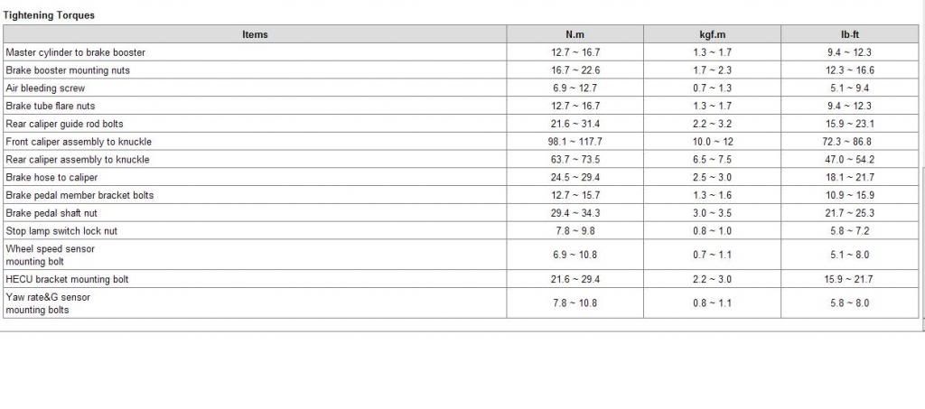

All torque specs
All genesis coupe torque spec's

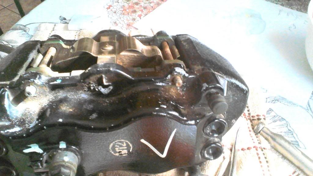

How to remove brake pads

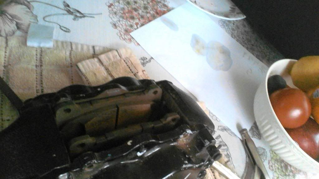

First look at it:

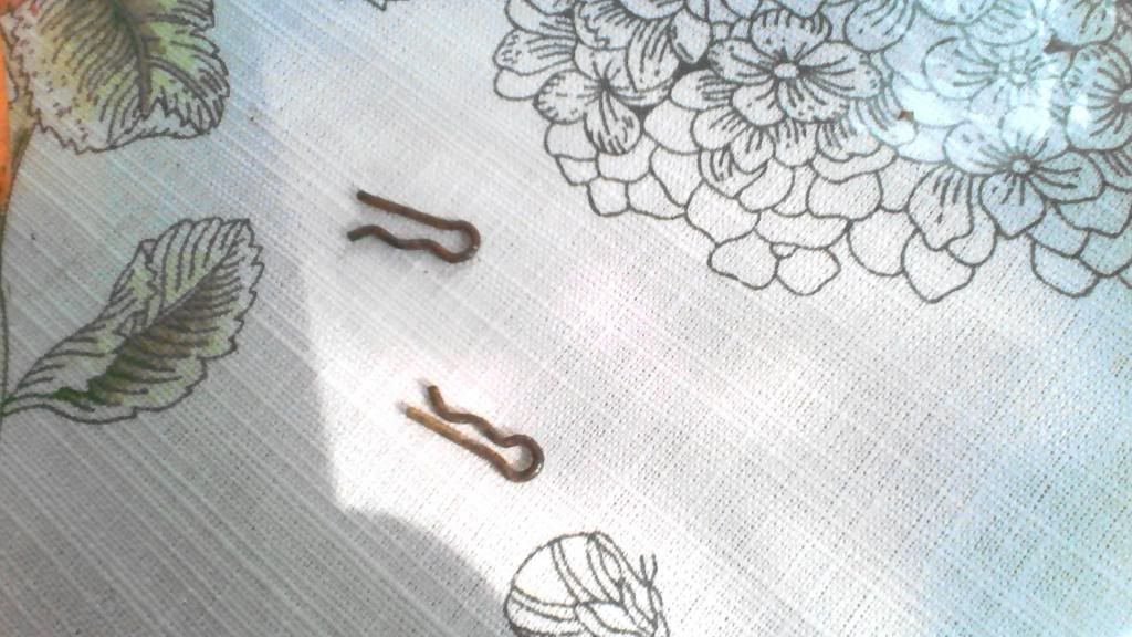

Next remove cotter pins
this are the cotter pins i refer to
Next force rods out

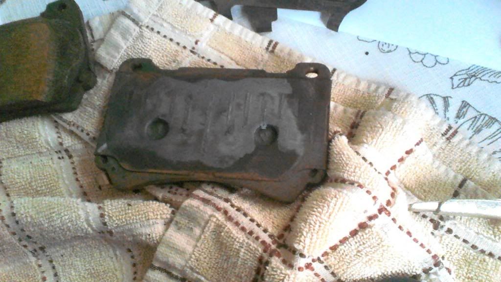

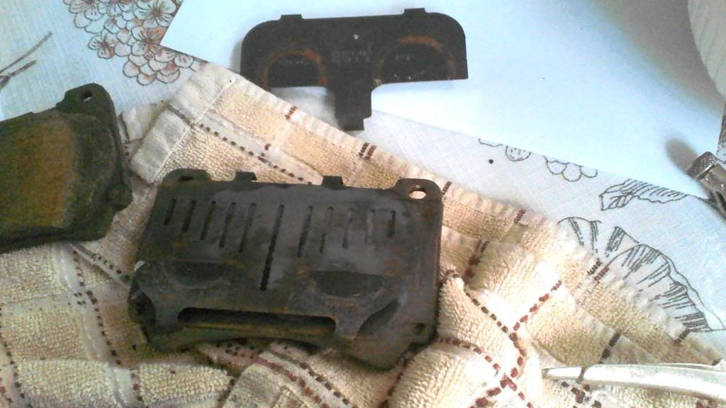

and there wiggle pads and backing out
Remove backing and save in order
Insert Klever Title Here

Edit: oh and Cris, those "tabs" you pulled from the slide pins are called cotter pins.
corrected and thanks

Torque Spec's have been added above

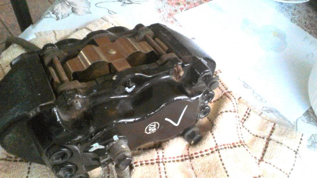

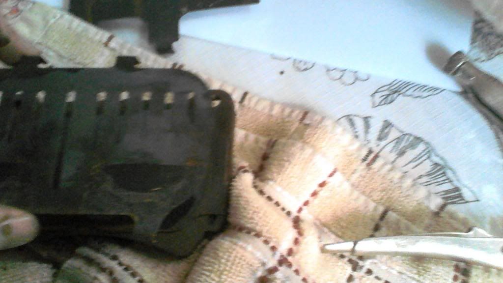

Remove it all
ok lets start with brake line
remove brake dust boot with this
and this is it
and you pop it off
next remove the piston
this is then how it looks
and your done go home your drunk

Nicely done Cris. You can also pop the pistons out of the calipers by using an air compressor, and do it slowly. Always have done it this way. Great job, keep it up. This will be a good guide for those that havent done it before.

ya i was worried the pistons where going to be hard, but they came out super easy. IDK if it's because it's dual or mono piston's are tighter, but this was much easyer then i expected.
Also i got the estimated mileage on the car, ~10k.
And there was rust on the piston. So i'd expect you high milage guys might really need this soon
