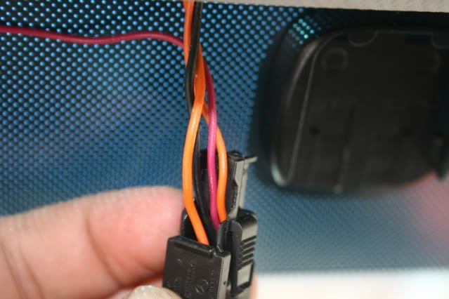

Step 1: Solder some lengthy wires onto your pigtail for the mirror. I measured about 6ft so I knew I'd have enough.
This is what the pigtail looks like:
And this is the pin-out of the connector:

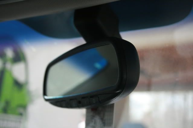

Slide Homelink mirror onto stock mounting location so you can measure when it's time to cut your pigtail wire to length.

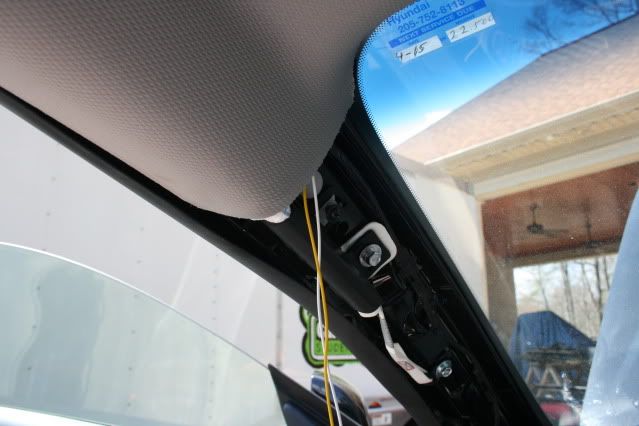

Take off the driver's side a-pillar trim. Do this by popping out the SRS tab with a trim removal tool of your choice. Be careful because the trim will scar easily.

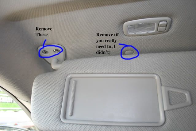

Remove the 3 visor screws on the driver's side.
http://i143.photobucket.com/albums/r145/mshale/Mirror install/RemovelastVisorScrew.jpg
Step 4:

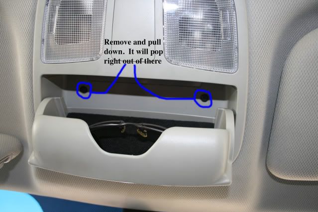

Remove the two screws inside the sunglasses holder in the center of the roof is.
Now pull down on the holder and it will pop out.
Congratulations, you now have access to all of the wires you need and a way to route them above the headliner!

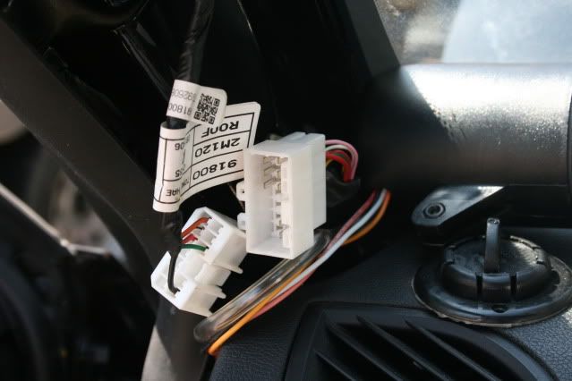

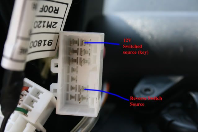

Unplug this connector (it will make it easier for you to apply wire taps):
Step 6:

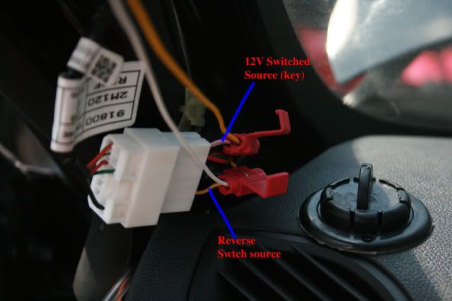

Route your new, long pigtail so that the connector for the mirror is sticking out of the headliner and the REVERSE and KEYED SWITCH wires are routed to the A-pillar:

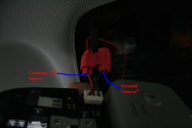

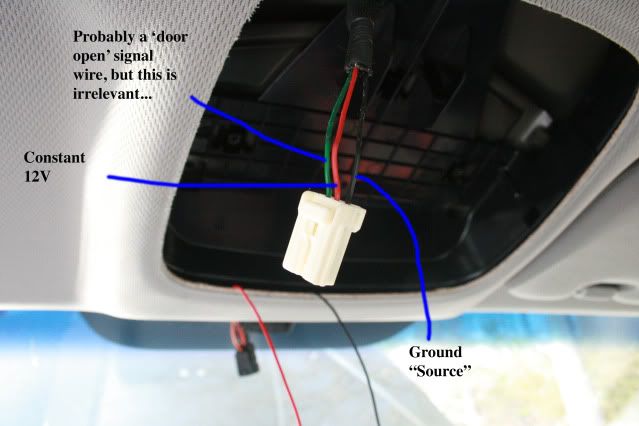

and the 12V CONSTANT and GROUND wires are coming to the map light area:

Cut wire to length and make connections at A-pillar:

Cut wire to length and make connections at Map light area:
Step 6:

Plug the mirror connector into the mirror and install the cover. Connect your battery, turn the car on (no need to start it) and make sure everything works:
