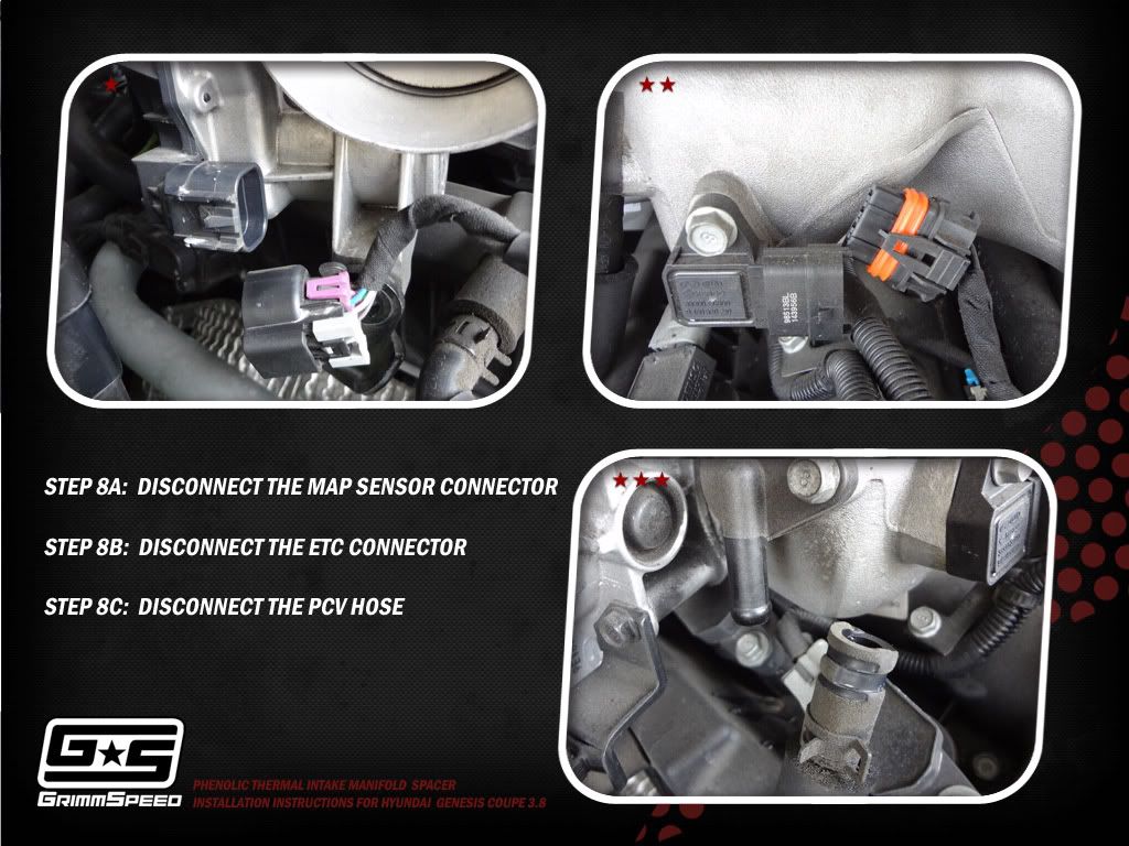

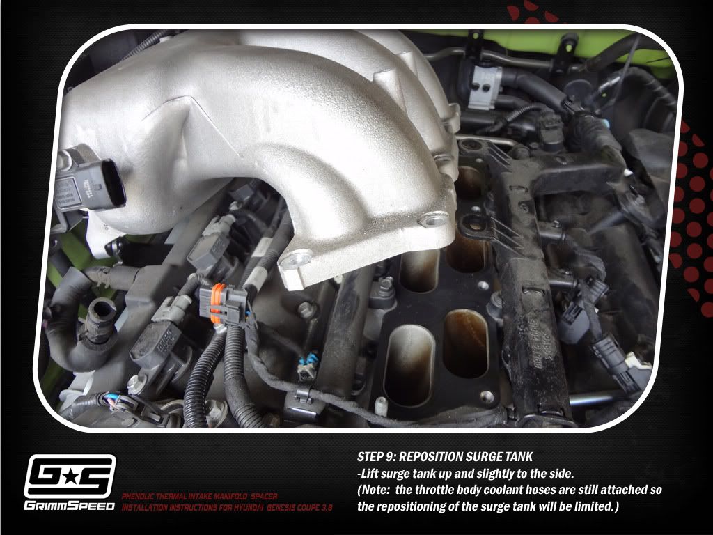

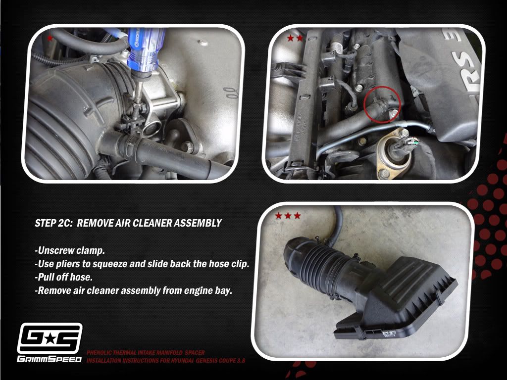

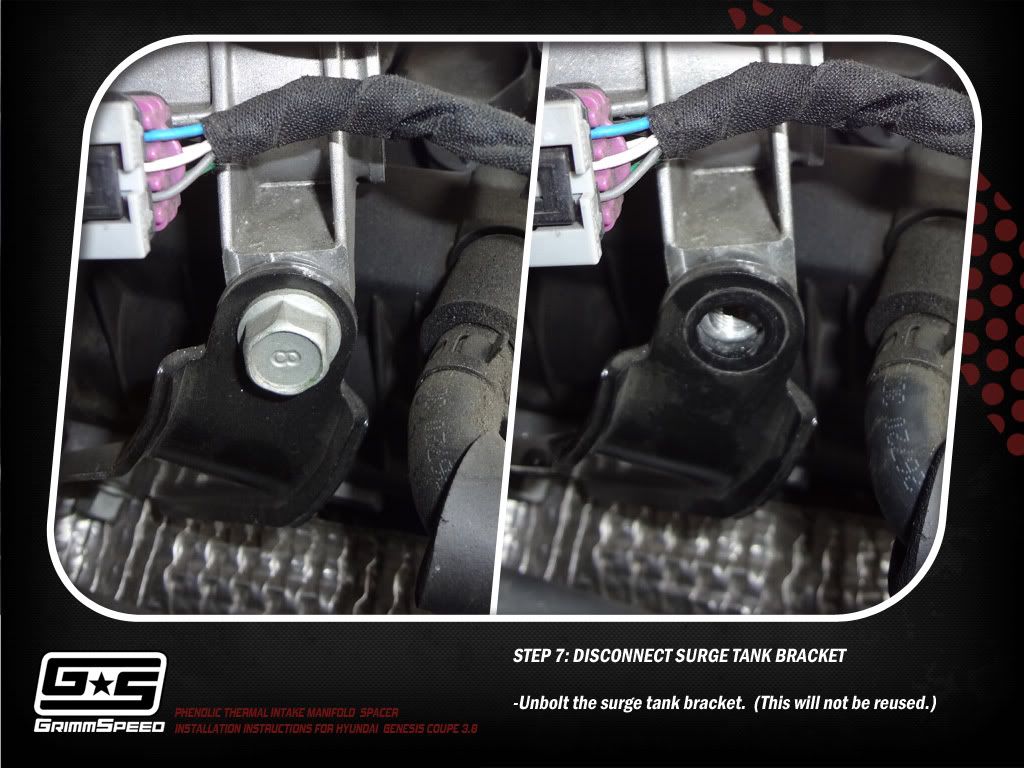

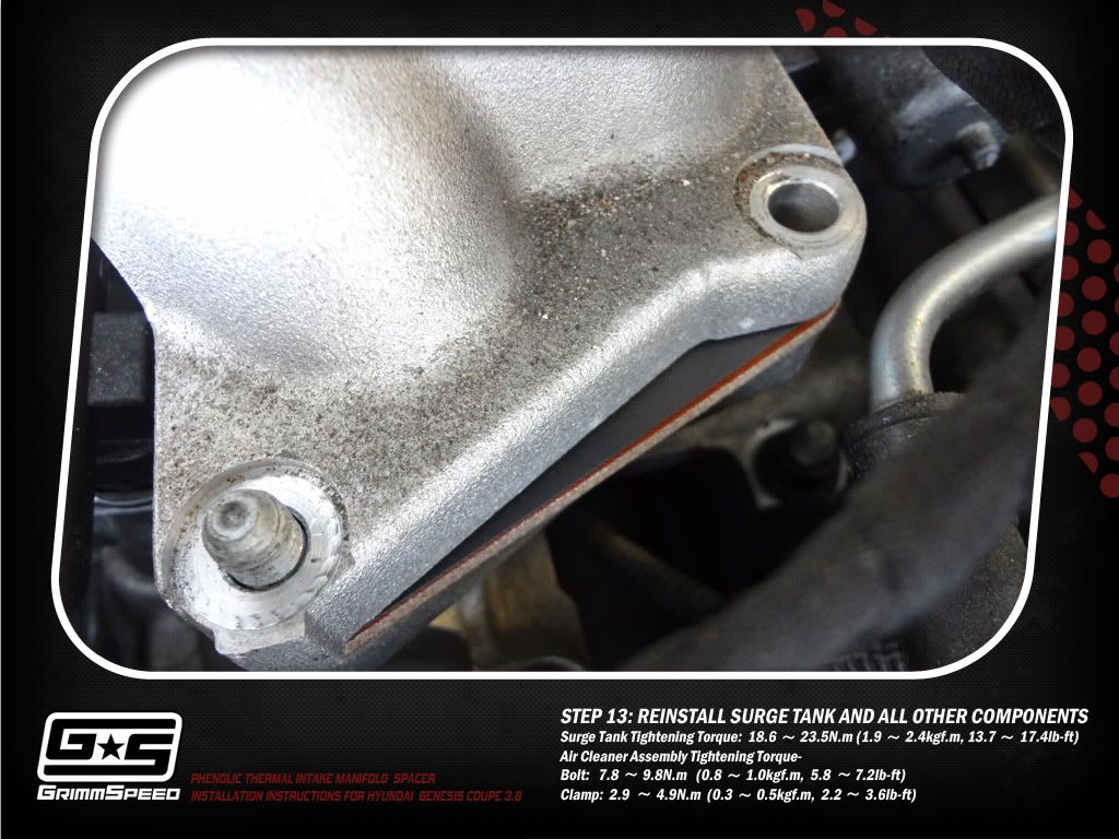

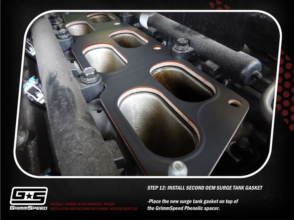

Note: The numerical system allocated to the installation steps in this DIY correlate to the numerical system used in the hard copy instructions that are shipped out with each phenolic spacer.
I'll provide a performance review once I've had it installed for a couple of weeks. But let me just say that this was a quick and easy install, so if you've been meaning to do this, but have just been putting it off, you'll be pleasantly surprised at how quick it goes :)

The grimspeed instructions are good enough i thought but this is very nice... This really is easy, hardest part for me was locating the surge tank bracket and that wasnt hard at all. Great write up as usual.

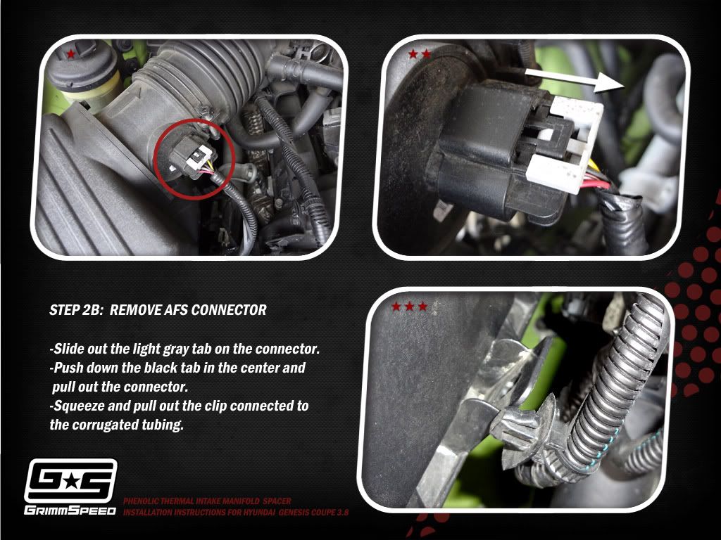

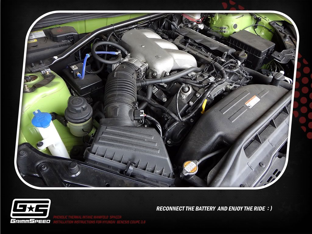

Hey, what is that thing with the blue vacuum hose connected, in the last pic
I think it for his f1 sterling exhaust controller.
Correct you are, it's one of the lines that goes to the solenoid valve.
