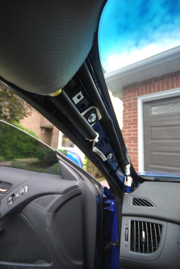

1- Remove the sun visors, any screws holding the pillars on, etc. Each pillar has to come off so that you can remove the headliner and each pillar has a screw holding it in, you have to pop off the SRS airbag clip to get at it.
2- Once all the pillars are removed and all the clips, etc holding the headliner in are out, you can start pulling down on the headliner. The are clips throughout, try not to break any of them. Just play around with it and you'll see where it's being held on.
