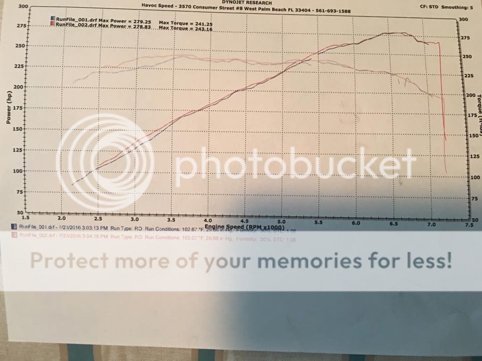

Hello everyone, Today I did a Dyno Test on my 2015 Genesis.
here's a video
https://www.facebook.com/song.chau.7/videos/1210169162334893/?l=5696571990592042028
here's the result
279/241
Modifications:
SFR Canned Tune
R2C Intake
Throttle Body Spacer
Throttle Body Coolant Bypass
Anybody have any suggestion what my next mod i should go for if i want to be pushing 300
Was looking around and saw stocks 3.8 pushing 270 So something tells me i'm not doing something right here.
2015 3.8 GDI MT

The only thing you've done to add power is the intake. So, 9 hp is about right.
A custom tune and remove secondary cats would be the next best things to do.
Doing track lessons would be good too.

You will likely get about 10 - 15 hp from a true dual catback exhaust. When I removed my stock exhaust, it wasn't just a single pipe, but it was pinched from the factory in 2 places making the restrictions even worse.

I would have expected a little higher numbers just from the tune. That does seem like stock numbers.... Any way you can give the dyno another go?

Your numbers are low even if you were stock. Saying that, elevation and temperature could have caused low numbers. Also are you runing premium 93 and was traction and stability controll off?
Temp of a 102 F definitely had negative impact.

Yeah, to determine if you're numbers are low or not, we need more information.
First off, automatic or manual transmission?
What gear were the pulls taken in?
Were traction and stability control completely turned off?
What brand and octane gas and is your canned tune matched to that octane?
Elevation and temperature?
The graph is also being shown in the STD standardization. SAE would read slightly higher.
But yeah, for more mods titan2782's guide is where I'd look at next.

These results actually seem about right. Granted all he has done to his car is an intake. The canned tune he has won't really do much at all power wise, it's more for the drive-ability. You need a custom tune and definitely get a full TRUE dual exhaust with 2ndary cat deletes before getting custom tuned. You will probably break the 300whp barrier with those mods. Look into getting a PNP throttle body as well before being custom tuned, it can help tremendously. I believe there was a thread around here where a guy with a Bk2 showed a 23whp gain with just a bored throttle body. Best of luck, I myself plan on upgrading my SFR canned tune to a custom tune as soon as I can get to a tuning event.

To tell you the truth, that intake is actually going to hurt you when you close the hood. Dyno numbers don't really mean much.

Let's do the math -
Under his name it says he's from Kileen (I'm assuming Texas), so 900 ft. elevation. Air temp was 102 degrees (F). I'll assume a Relative Humidity of 50%, which is likely low for Texas this time of year. I'm also going to assume 270 HP at the wheels stock.
HP LOSS = ([elevation in feet] x 0.03 x [HP at sea level]) / 1000
Numbers come out to a LOSS of 34.2 HP.
If he were to run the dyno on a "Standard Temperature" day (59 degrees F), his loss due to elevation would only be 10 hp. I hope you guys at Sea Level feel sorry for us at some elevation with hot temps. ;)

I know it's been years since I posted this thread, but I just wanted give you guys closures. Lol
During this time when I had my vehicle dyno,
I was in Orlando, FL
My Genesis is a Manual
Not sure what gear the pull was taken in or if the TCS had been disabled and what dyno
I was running 93 and used mainly Mobil Gas when I could.
and this was a free dyno for a local tech. school for a event.
I've since took everyone's suggestion and added Ark Performance downpipes, Ark Performance Testpipes, and Ark Performance Catback and a Custom Tune from BTR.
My new results came out to be 305WHP and 280TQ. Thank to everyone, I finally broke the 300WHP barrier.
