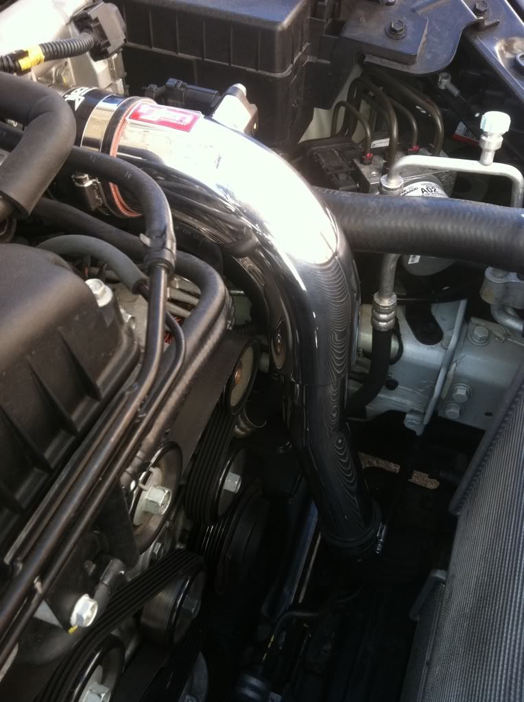

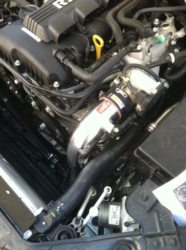

Injen Hot and Cold Side Piping - Part II
Here is the final product today. The turbo side was a bit harder to get on, but I managed to do it in about and hour and a half.
[/IMG]
[/IMG]
[/IMG]
The harderst part of this was that you had to go under the passenger side of the car to get to the clamp that hold the hose on the stock intercooler inlet. Once I got that off, everything was clock work. Any questions, feel free to ask.
