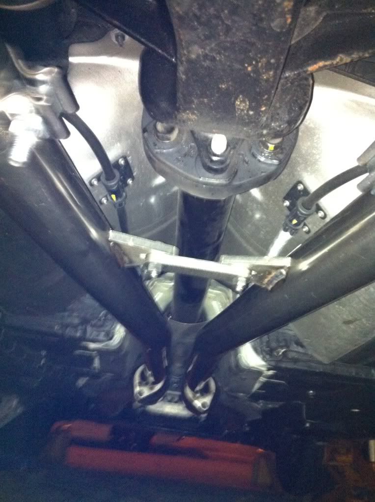

Removing Black connector bar
Go back under the car and you will see a Black bar connecting the stock pipes:
A 10mm is required for these. You know the drill... if they are hard to move WD-40 is the answer. Once that is done take the bar out from under the car.
