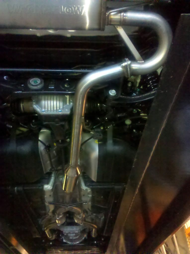

I have a RMR Axelback attached to the stock mid pipe. I love the sound of it. I would, however, like to tone it down (a hair) and deepen it's note (a hair). The muffler is a Magnaflow. It has a great low end rumble at idle and it is hardly noticable (as in no drone) at highway speeds.
Under load, going through the gears or up a hill, it is significantly louder. It can be a little "boomy" in 2nd gear (think short block with a stop at the end. Too long for first but not enough for 3rd).

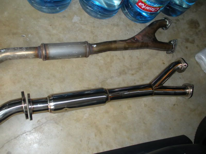

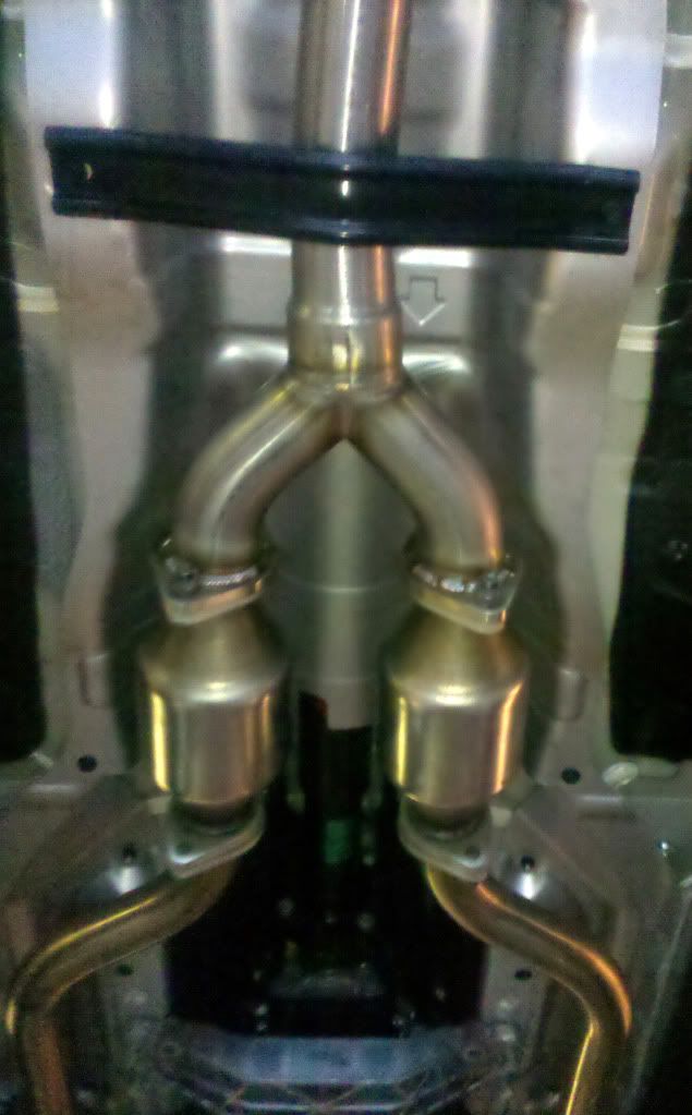

I went ahead and had a custom midpipe put together. I found a shop in Pasadena, MD. that can mandrel bend stainless steel. They used 409 SS for mine. I believe Megan is using the cheaper 304 grade (hence, the polish).
The pipe is connected to a Rhys Millen Racing Axle Back. The pipe is 2.5" in diameter hosting a 18"X5" Vibrant Resonator.
Here is a link to the said shop: Mandrel Bending Solutions Home Page
The Y pipe has a small curve to it (pointing towards the rear connection). The poor lighting and the said curve give the resonator an off set appearance. It is more or less an illusion.
How much $ if you don't mind me asking?
I got a quote and my local custom exhaust shop and they said that they couldn't touch the price of a pre-made midpipe.
The Y Pipe. The mid pipe, resonator and SS flanges cost me $422.00 installed. Worth every cent.
