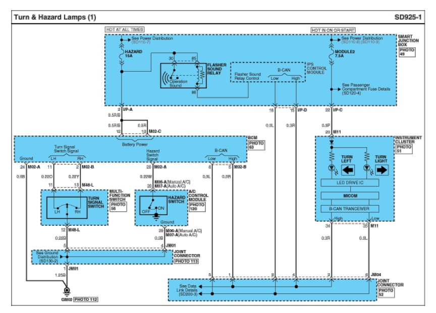

Here's a wire diagram. I would disconnect the BCM to see if the current draw drops for your next test.

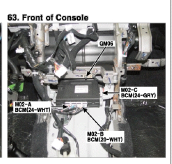

It's my understanding that the BCM is in the center console under the radio stack. Is it possible that the aftermarket headunit install, and all the rewiring, tampered with the BCM somehow? Nicked a wire? Crossed a wire?

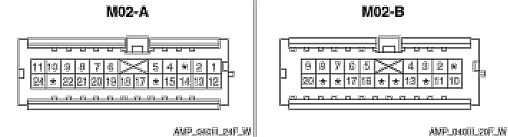

I would reseat the 2 connectors on the BCM. Easy to do.

On BK2, hazard fuse also controls BCM. It's very easy to keep BCM awake with crank audio equipment or canbus issues. The OE amp just wasn't playing nice with the new head unit. Inexpensive Rockford Fosgate replaced the OE amp and all was well.
