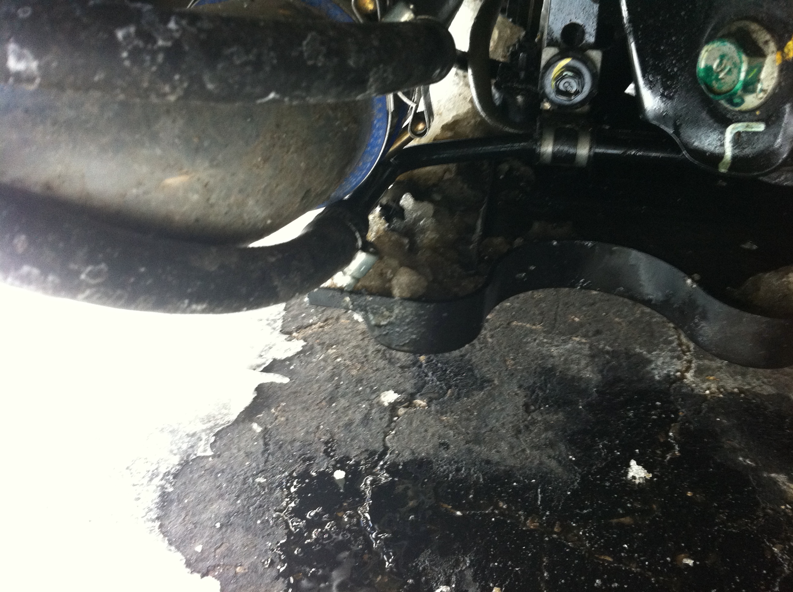

So, I found where the leak is... Not sure how to fix it, it looks like the hard, plastic part of the line must have a crack or pinsize hole in it. The fluid bubbles out of it. Here's a pic, took a video too but the fluid had all drained and there was no more leaking.
Big image btw, but its better you can see at full res so click the url for the full size one. The bottom part of the line, right where the little hose clamp is near the FMIC is where it bubbles out and leaks.
Any ideas on a good way to patch this up? Epoxy maybe? Not sure if the power steering fluid would eat away at that.

Just get the proper part and replace it. Do not do a patch job on it. Chances are it will leak again. Get the new part and positon so you do not have the chaffing that caused your original problem.

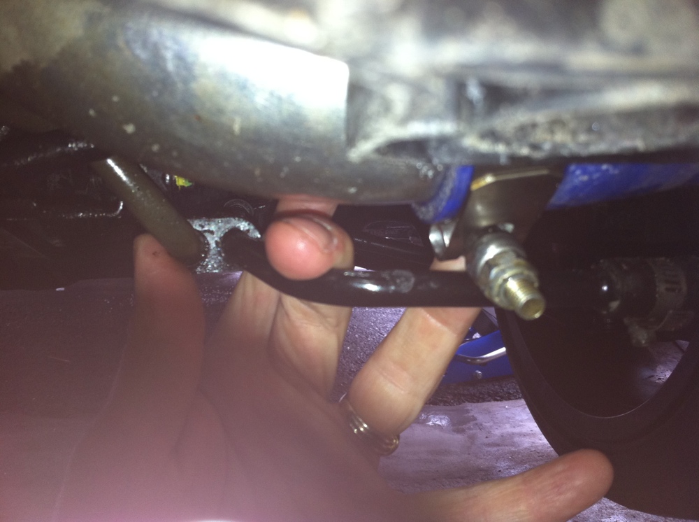

So my fmic's tblot clamp gauged a hole in the metal line. Check the picture out. I cut that piece of line off with a hacksaw and attached the silicone hose to the metal line again. Seems fine, but I'm a little worried because there is no "nipple" at the end of the metal line like there was. I tightened the hose clamp really tight but there isn't anything leaking now. Hopefully it will stay that way.
Anyone with a new fmic and t bolt clamps on the u bends should double check the ps line is not rubbing on it. You can actually push the metal line torwards the back of the car for extra clearance.
