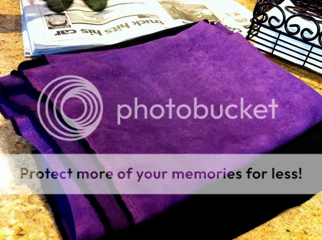

i'd love a purple interior but have a hard time seeing suede on a sports car . . you need to follow it up with the purple NRG hub and steering wheel!
386 Posts
PERFECT! Wow thanks for pointing that out! The purple might just be temporary if I can't get a reasonable quote on the seats.. The fabric only costs $37 and the spray adhesive was $19.98 for two cans :p If I get sick of it I'll change it up accordingly to the seats I purchase ;)
where did you get the fabrics?

That can't possibly be real suede for that price. More like micro-fiber or something like that. As long as your car is red the purple will be pretty weird looking, but it'll go well with black/ cf.

:bowdown: If I had the money to respray the exterior of my car it'd be a midnight purple like that. Not sure what this'll look like with the grey a-pillars, since everything else in the car is black. Maybe wrap those as well?

So it doesn't look like the headliner would be that hard to remove- Or am I mistaken? What all did you have to remove to get it out, and then does it come out the doors or out the trunk or what? Sad to hear the purple got messed up :(
The headliner was pretty easy to remove as long as you're confident in what you're doing and trust in your prior knowledge that you're not going to break a ton of clips LOL. It took me and a buddy not even 10 minutes to pop it out..
1. Disconnect negative battery terminal. (Having a side curtain airbag blow up in your face would SUCK!!)
2. Take out A-Pillars.
3. Take out sun visors.
4. Take out Center Map lights and Vanity Lights.
5. PULL DOWN HARD! :rofl:
Then you have to kinda fold it to pull it out of the car.
