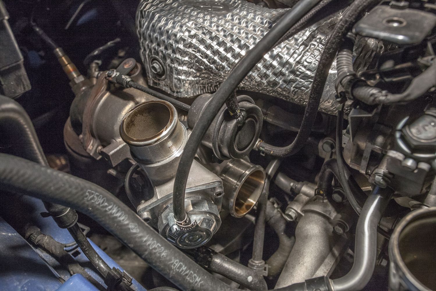

This is why you need a catch can, all this oil goes right back into your turbo / intercooler/intake system unless you have one. Yuck!
You get oily gunk both on the inlet and oulet of the compressor housing, and basically everywhere else too. If you let this go unchecked long enough, you'll end up with pools of sludge at the base of your intercooler.
