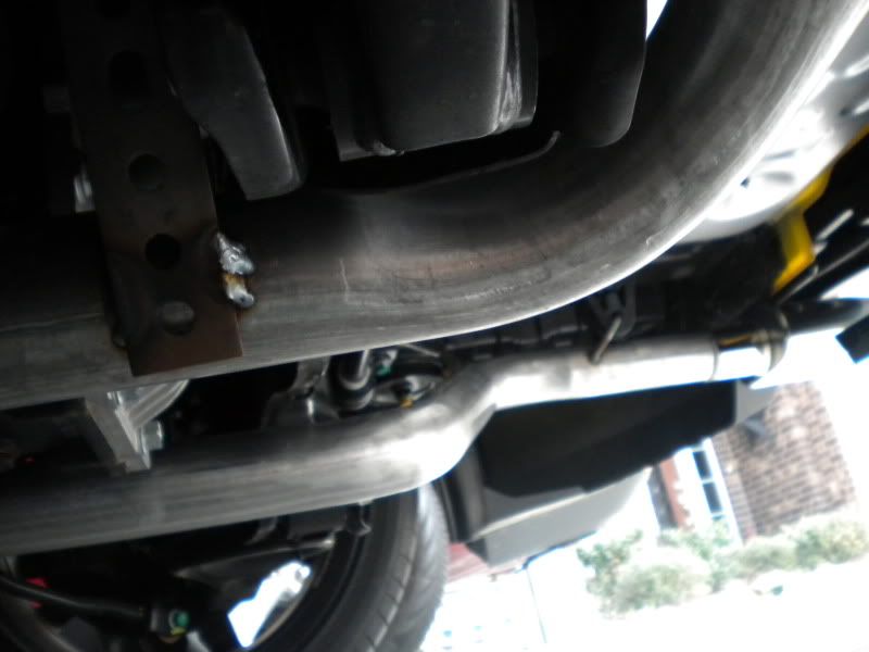

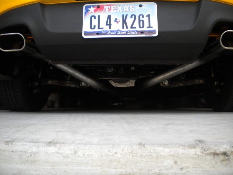

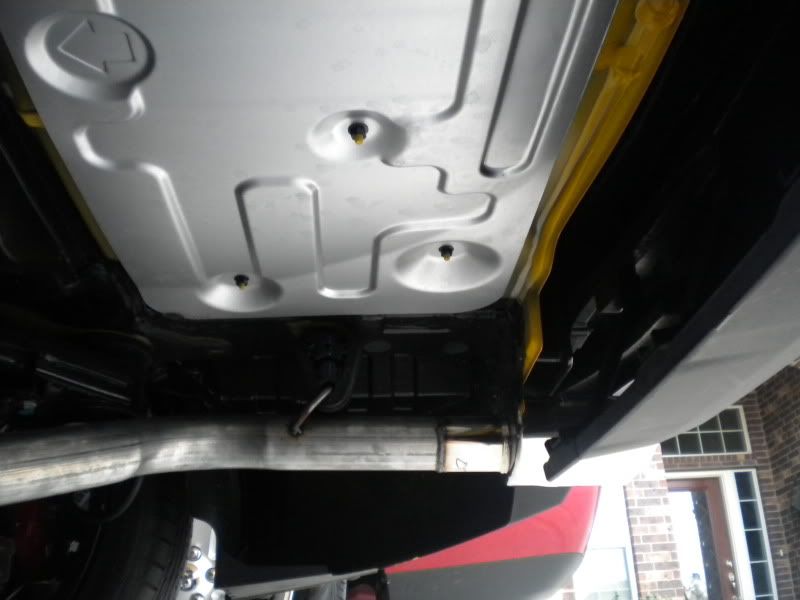

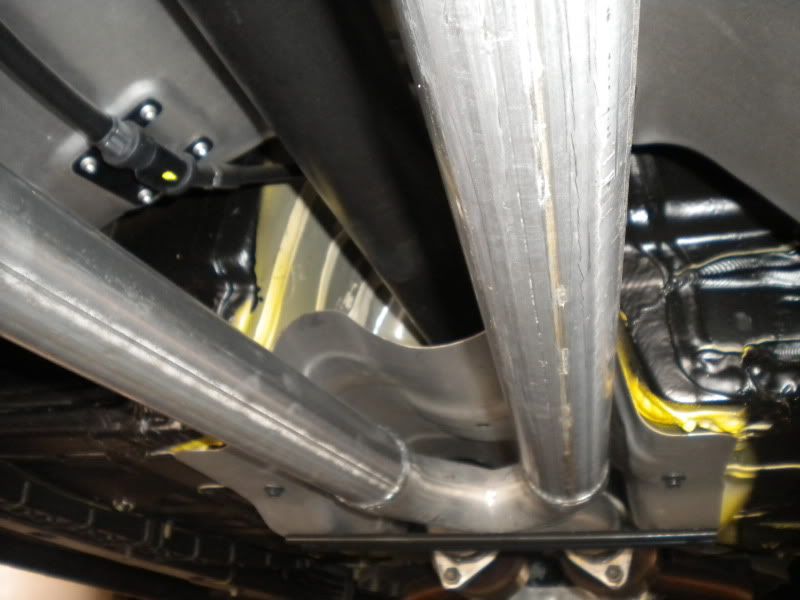

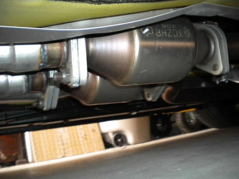

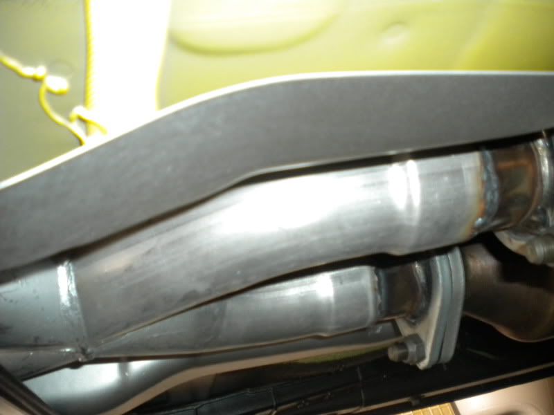

Well I have been wondering what exhaust to do forever now. Well after much debate I have decided and it is totaly not what I was thinking I was going to do. Streight Pipes, I know Some might bash it and that is okay. But I have a question does anyone know where the last O2 sensor is located. I want to keep the CATS right in front of the flanges before it Y's. I just want to make sure there is no O2 Sensors after that, I don't want to throw any codes.
**UPDATE**

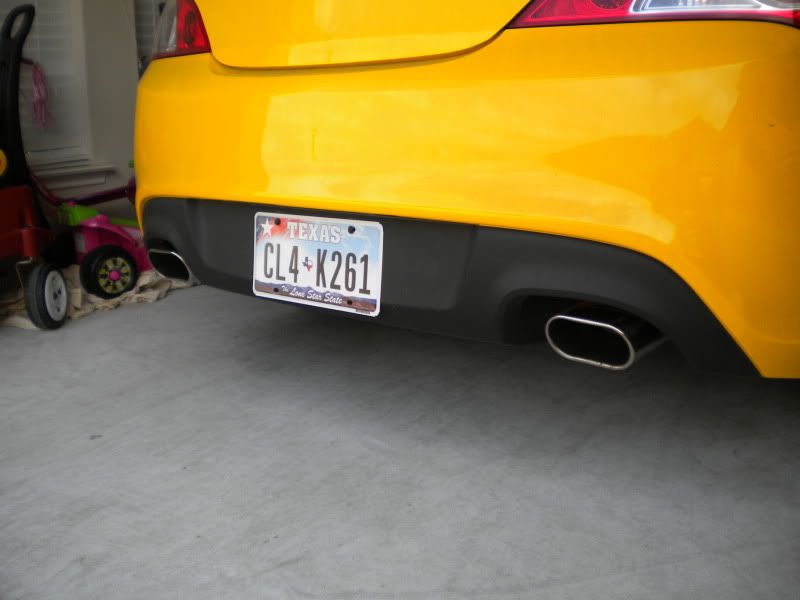

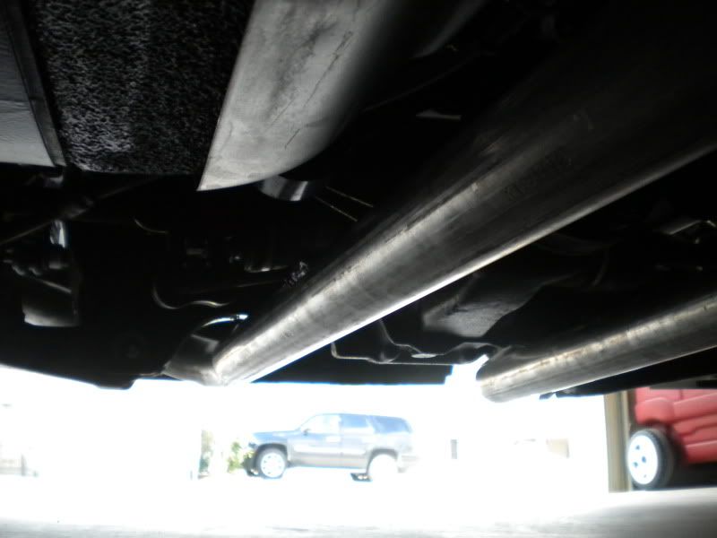

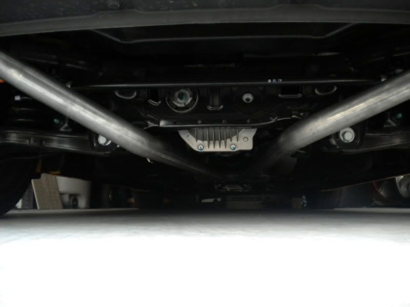

Okay well it is all done: right after the second cats a X pipe and then 2-7/8" pipe "Straight" all the way to the back. I did not put Quad tips on because I wanted to be different, and I like the final look. The shop did an outstanding job. Now as for the sound It is MEAN!!! Not too loud on a low load, but under WOT it screams. I will get a vid up ASAP, but for now here are some photos.

second O2 sensors are on the downpipes before the 2nd cat. you do know that straight pipe means no restriction at all right? that means no cats either. i made a vid a while back with headers and straight pipe. it's way too loud. you'll get a ticket. but it would be nice on a track. also you're not gonna find a good exhaust to properly pull off straight pipes with good power and tone. but if you don't know where the O2 sensors you may want to think about your idea a little bit more.
