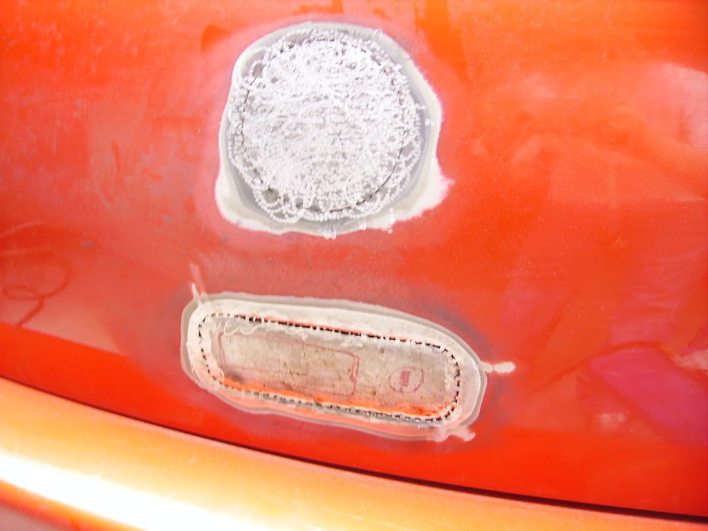

I have only seen two people to do this. Pics Bellow. Anyone else do it? I am getting quotes around $300 to prep, fill, and paint. Sound high? Thoughts? I know I can just get a CF and get it painted, but in the long run thats a long more effort and time.

Depending on what they're filling it with you may have shrinkage problems in the long run. When the fill shrinks you'll see the circle reappear. Annoying if you're a perfectionist. Is the shop going to guarantee their work for more than 2 years?
You could fill with fiberglass, then go over with Bondo for finishing to fill pits, that way it won't "sink" so easily.
you don't want them to use any kind of filler to fill in the hole... you want them to tack weld in sheet metal and smooth it so you get a consistent finish... here is an example:
might pay more.. but the result will be better.
