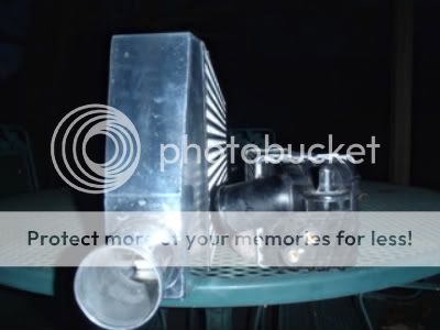

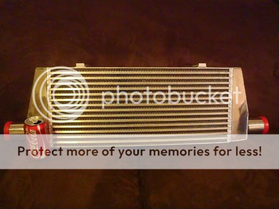

This thing is huge! Everything it came with looks very high quality.
TurboXS's customer service = A+

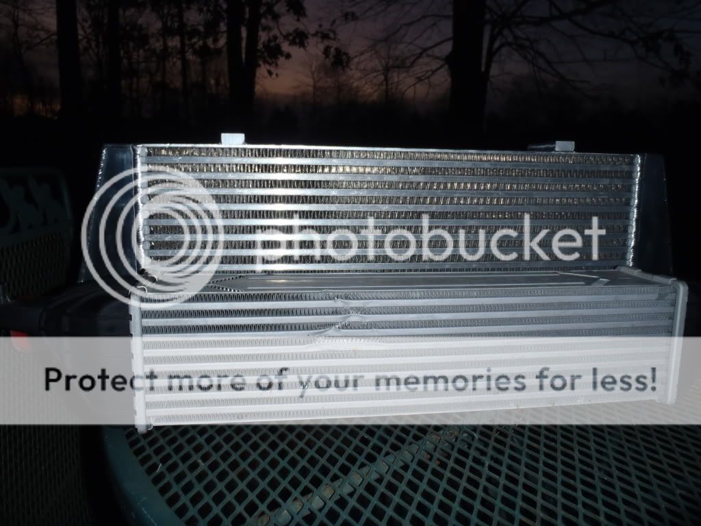

before:
Stock vs TXS
OEM = 5.5 lbs
TurboXS = 16.5lbs

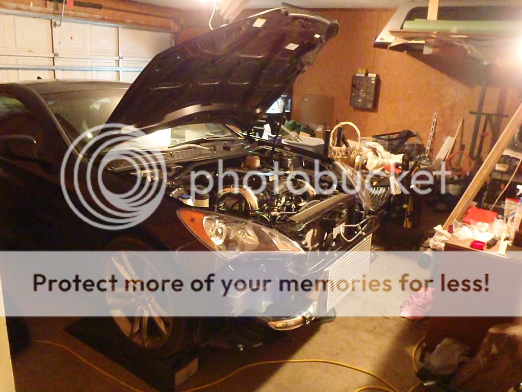

In my friends junk filled garage. Way too much crap in there lol.

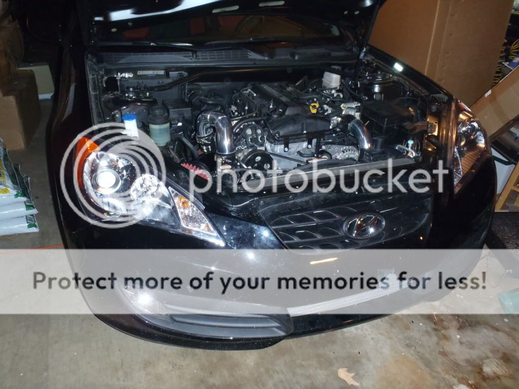

^Note: I switched the passenger side T-blot clamps around so they match the driver's side and pointed them as far up as I could. The bumper won't fit if they aren't positioned correctly.

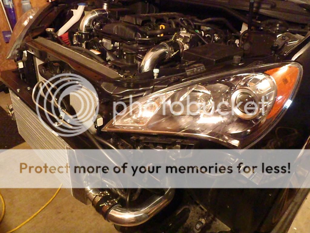

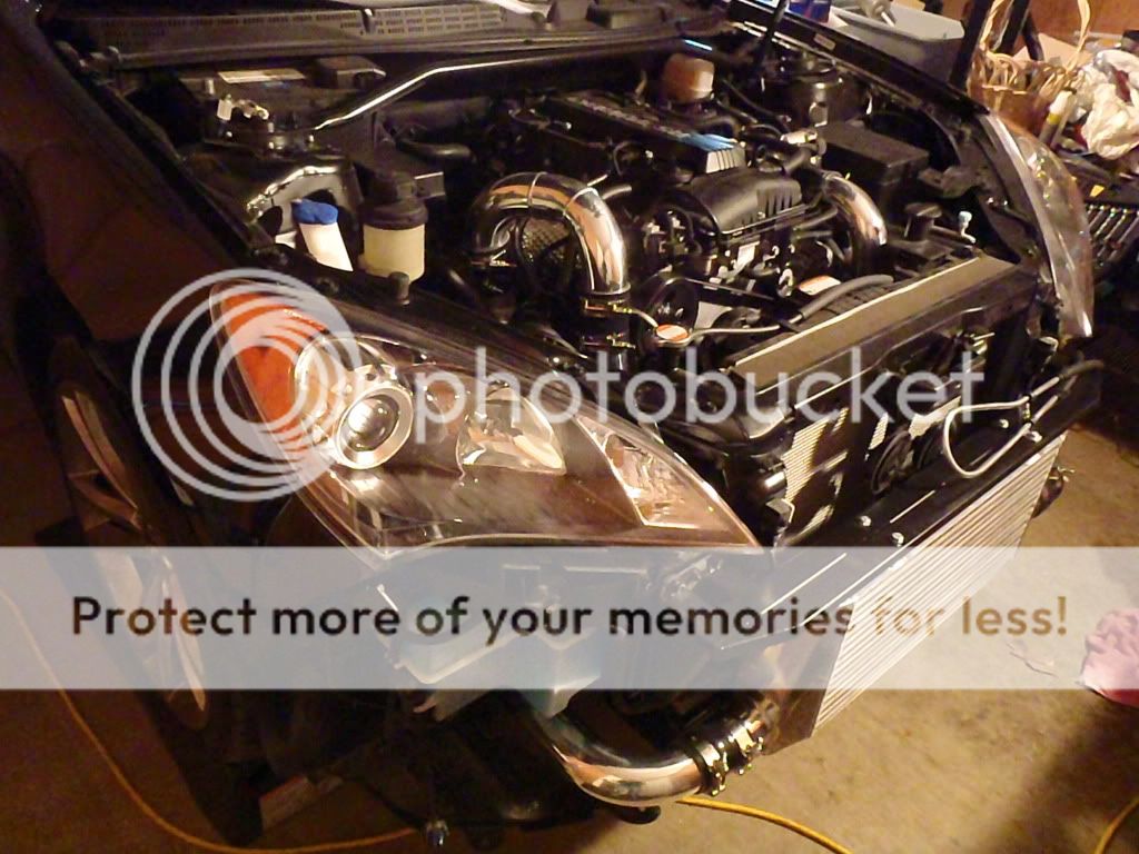

With the bumper almost on:
^ New bumper coming soon, a truck backed into me, so the 300 bucks for a new OEM IC went toward a shiny TXS one :D

The install went smoothly, the hardest part was getting the OEM IC off, it took a while to figure out that you have to pry it straight up to get it off. Also I read somewhere else on here that not much power steering fluid came out when swapping the hoses, which is complete BS. Not sure why I thought it wouldn’t come pouring out lol.. Just let them drain and buy some more fluid before you install this. I made a mess. Another tip, you have to slightly modify your bumper to get this thing to fit. My friend and I literally spent a day and a half adjusting the pipes trying to make it fit around my bumper. I even took the car to Motorsport Authority (awesome guys, awesome shop, awesome turbo V6 Gen :p) and they said I did everything right, but the pipes just went out too far. [email protected] confirmed this, so I got a Dremel.
Pics. [email protected] was extremely helpful and offered to make a new pipe to fit with the fogs, but I think a little cutting will make everything work.

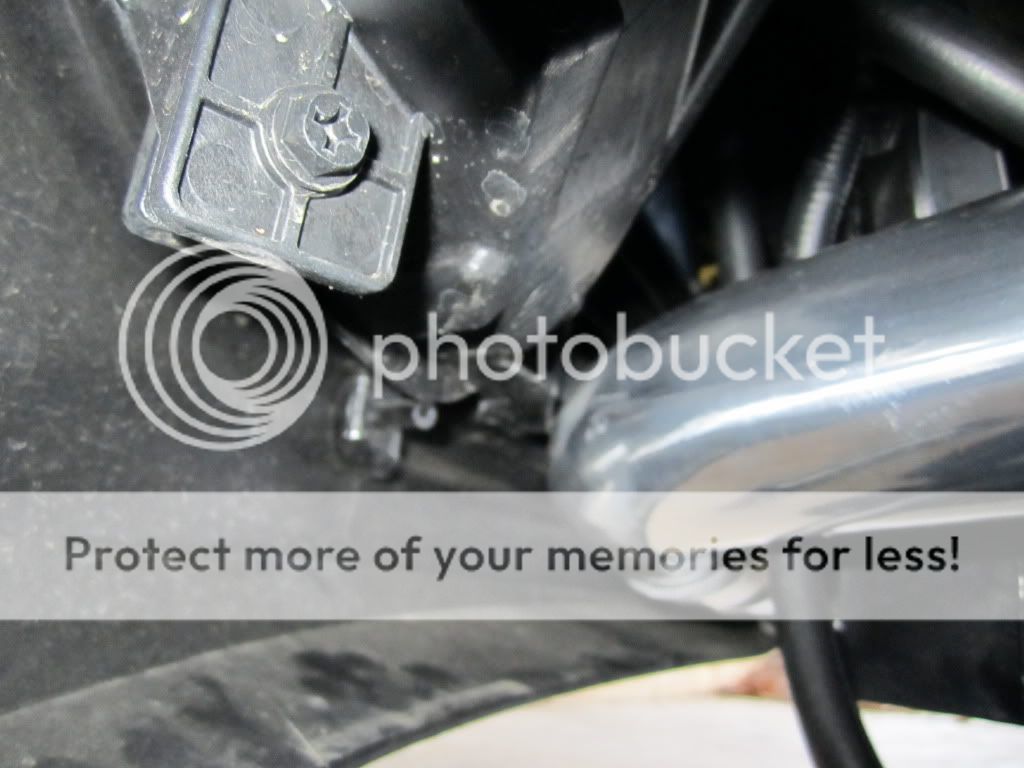

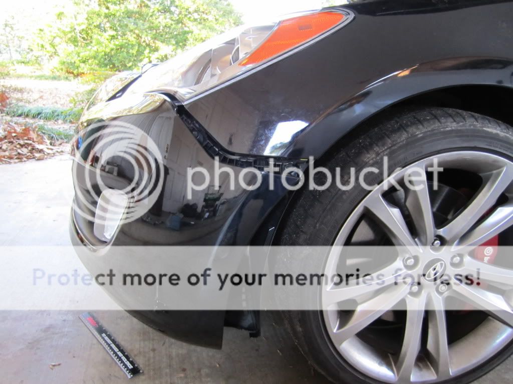

Here are pics of the clearance issues before messing with the bumper:
This is with the cold side pipe hitting the bottom support arm for the fog. Passenger side does the same. So I took them out but it was still barely hitting the fog surround where that bottom fog arm was.
This is the camera stuck through the fog light hole.
You have to cut this tab and sand it down. Here's how it fits with it gone. Mark said they had to cut this off their car too.

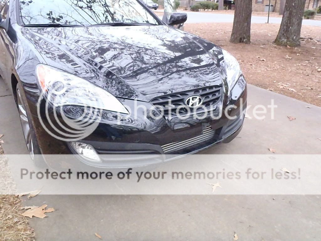

At this point, the bumper goes on easily, and that's how I'm driving around right now, have been for like 3 weeks lol. My friends and I can't decide if it looks awesome or ghetto. Maybe a little of both lol. I was hoping to cut up the fog light and surround today but it's raining :mad:. Just a little needs to be sanded on the back of the bumper so it will have a little wiggle room in front of the core.
Cut off that tab in that same spot of the fog surround on both sides, then cut the bottom support arm off your fog assembly. Sand all that junk. Whoo! -(pics to come soon)

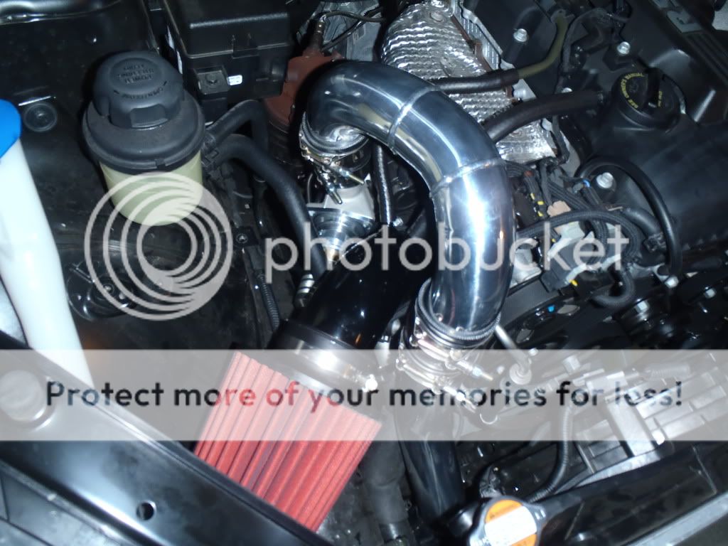

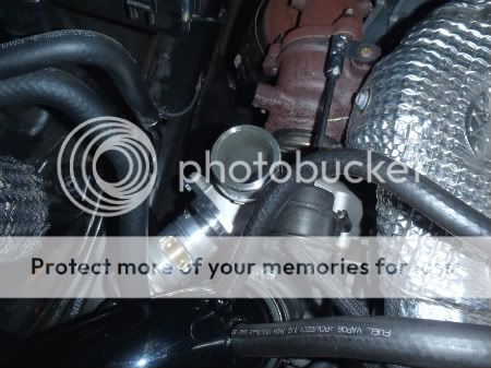

Also the TXS Type-H BOV is awesome!
The fit is kinda tight in the stock location because it is such a big valve. I’ll have MSA weld the flange on the IC pipe eventually. Now I just need a tune so that I won’t overboost and go into limp mode….

here is the pic of mine after the install. i will be taking the plastic grill pieces out very soon.

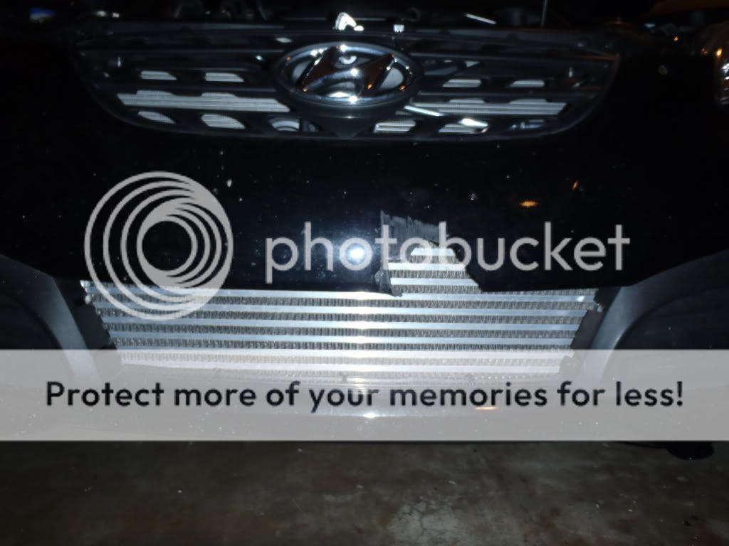

How're you guys removing the grill part in front of the FMIC? Dremel?
There is the black plastic grid like this: # that is just held in with 4 screws from the back. Then there are 3 vertical plastic strips behind there that you have to cut off. Mine were broken from the *******'s truck so I just used a small saw and didn't sand them down, it looks like crap. IDK how to make it look totally clean without using touch up paint at the base of the strips once sanded down

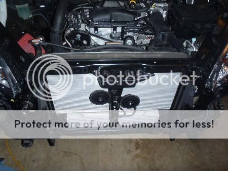

h\when i did my install and toke out the oem intercooler i noticed thar was nothing to hold the radeator up n place ,so how did you get yours to stay up
762 Posts
Ah I forgot to put that in there, you have to use radiator support brackets. I got them from Beyond Redline, they had the best price that I could find. They were easy to install, you use the 4 OEM bolts that went to the IC but I had to buy new nuts for them. Sorry for the crappy pic, my camera sucks
