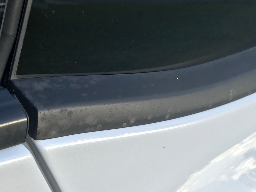

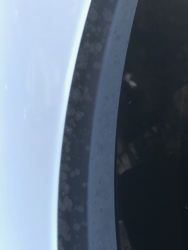

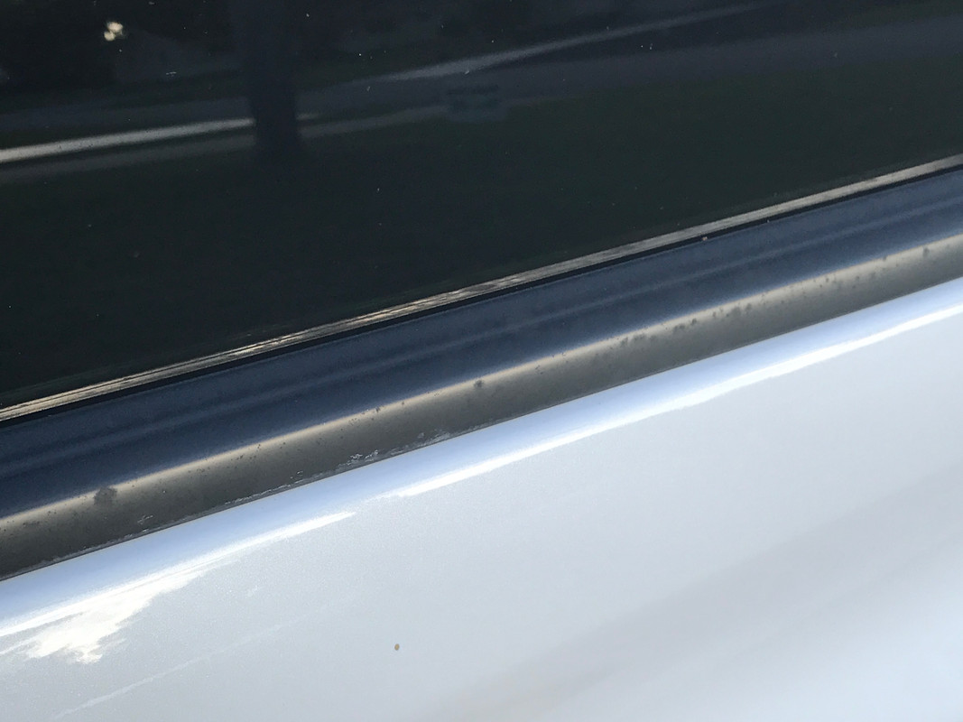

The rubber moldings/trim (all of them except the molding around the top door windows) is discolored and rotting. Thankfully my local dealer is going to replace it... Downside is, they have to replace some of the glass (rear small panels have the rubber glued on from the factory and can't be replaced)
So I get to have my car taken apart to replace cheap rubber.

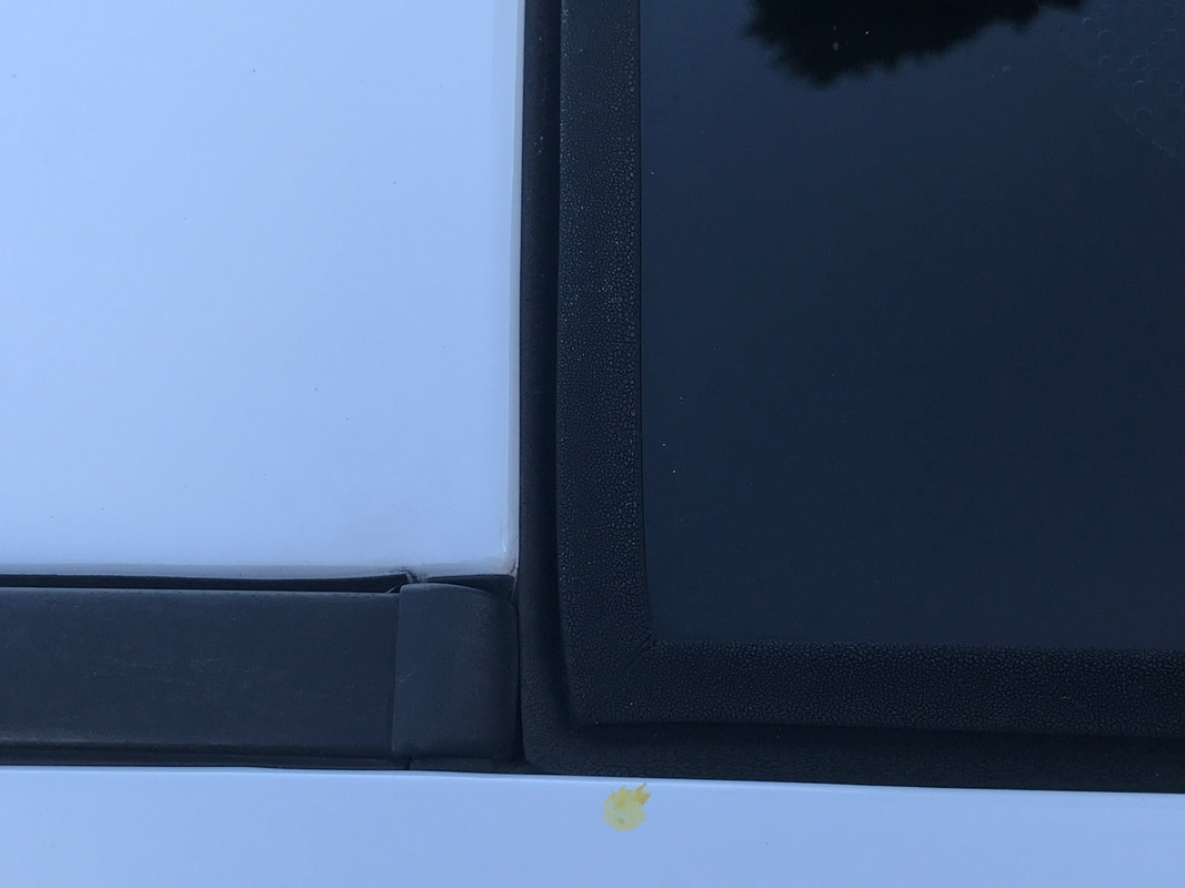

I also noticed that the moldings on my car are slightly different than a 2014. The 2014 has a line that routes out at the bottom. Mine just runs flat. Pics attached for your viewing displeasure.
Anyone else have this issue? My lease is up in 3 months... I wanted to keep her, but I can see how they price them so low new.

All those same mouldings, including those along the roof line, were faded,spotted, and discolored when i purchaced my 2014 ultimate new 7/14. I assumed it was because the car had sat in the dealers storage lot for several months in the hot desert sun, manufacture date 1/14. I go over them once a week with detailing spray and a microfiber cloth and they came back and have been fine ever since, i think i kind of slowly wore away a thin layer of weathered rubber.

I use Meguiars detailing spray on a microfiber once a week and kind of buff it into the rubber mouldings, when i started doing this it took probably a month or two, like between four and eight applications to get the mouldings to loose that dull brownish/spotted discoloration but it worked for me. I do think theres somthing wrong with whatever type of rubber they are using as it shouldn't do that at least not in such a short amount of time.

As anybody with a sunroof know, you have to condition the rubber. (if you don't for the sunroof, when you have it closed, with will start to creek)
Wipe down with silicone spray or tire shine on the rubber window parts after every wash.
All rubber parts are normally made from a petroleum base, meaning oil.
Oil leaks out of the rubber and (chemically speaking) rancifies, or breaks down and evaporates.
This causes the rubber to become hard and brittle.
For this very reason you DO NOT put petroleum based oils on rubber. It will only go into the surface and make the surface gummy.
Silicone spray and tire shine are not petroleum based because of that.
