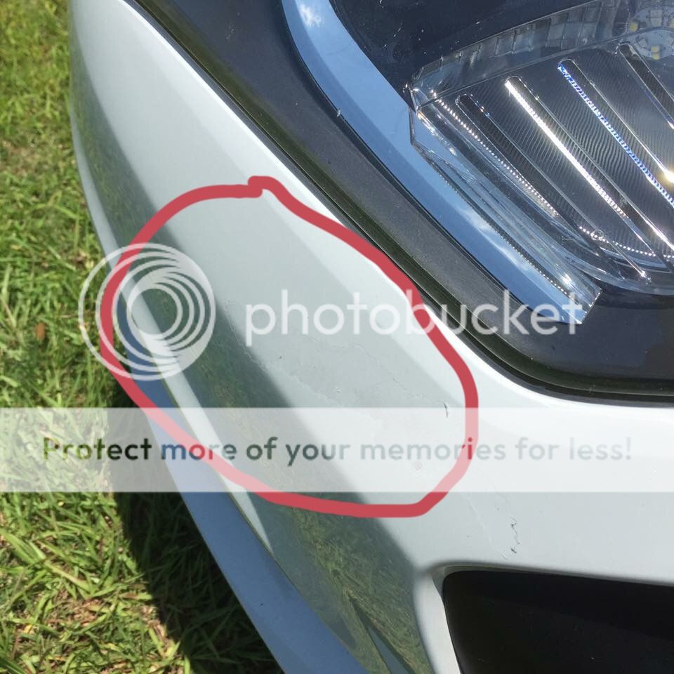

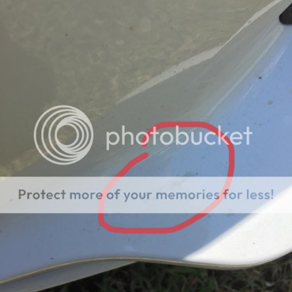

A couple of months ago while washing my car I noticed a few tiny yellowish-orange dots on my front bumper very close to the hood. These spots could not be cleaned off and and could not be felt when running my finger across them. Over time they began to multiply and just last week the clear coat began to bubble and separate. I took the car to my dealer yesterday and they are taking the car next week to repaint.
The pictures below were edited to show more detail than in reality. That is not dirt you are seeing, it is underneath the paint!
Do you live near railroads? That looks like rail rust spots. They come off, but are very difficult to remove. Wax often to keep it from coming back.

As I said, I took it to the dealer and they repainted the front bumper. Now the spots have begun multiplying on the rear bumper, so I have decided to wait till it gets bad enough to take it back for that. My 3 years are up at the end of next March so I have some time.

For anyone with the orange dot issue. It looks like iron particles that penetrated the clearcoat and started to rust from the inside (IFO or Rail Rust). If you wash, wax and seal often and claybar every now and again they usually don't even appear in the first place. The Clay should also be capable of removing the metal and other debris from the clear. It's brutal on white & silver paint especially. On my car I've only got a handful of spot, and I bought mine used at 107k km. 143k km now and no additional spots because I take very good care of my paint and finish. I have yet to clay the car, so that'll probably happen early this year, maybe even before I drive it again out of storage. I need to go in for a new front bumper, and paint and repair the back bumper, so probably after that cures. Here's a little write up I found on this actually: Orange rust dots on paint - Team Integra Forums - Team Integra
