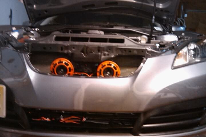

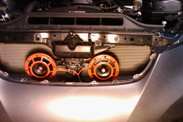

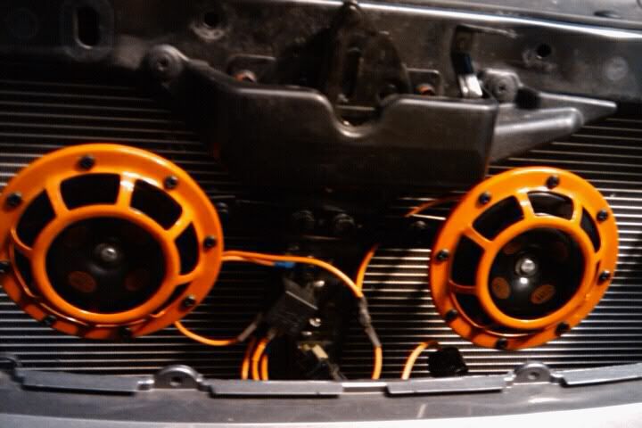

Just finished installing my supertones hella horns. Install was pretty easy if your good with wiring. I made the support bracket out of this metal bar with holes in it from the plumbing section of Home Depot. All the wiring I made myself with standard 14 gauge wire. Difficulty out of 5 I'd give it a 3. 3 being because making all of the wires and figuring out where to place all the wires took long. Overall, the sound of these horns are very loud.

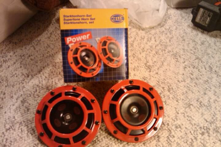

Here are what the horns look like.
Here are the horns installed close up.
Now a little further.
And the furthest.

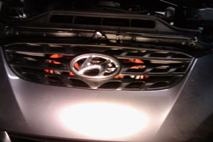

And the horns behind the OEM grill.
Its difficult to see the horns behind the oem grill cause of the way the grill is made, but I have a luxon grill on the way so it will show even better.
